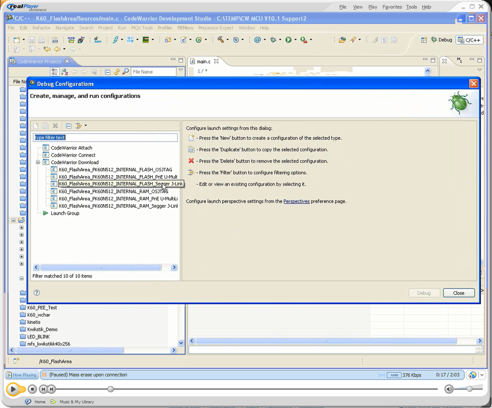

Then if you are using CodeWarrior please see the video Mass erase upon connection in the folder I shared before, once you open the debug configuration window, there it should be an option with J-Link, select that option for your device (K70).
As example in video show:
If you are using J-Link commander please see the video Unlock Kinetis JLink and falow the instructions in order to erase your device.

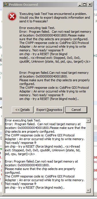

i am using MCF54415 with CW10.5.
i am facing one issue in writing to External Flash.
attached is the snapshot for the same.
please help me out of this issue. thanks in advance.

Here is a zip folder with some videos that show how you can performs Mass erase in order to unlock your device
please check it out and let me know if this works for you. :smileysilly:
