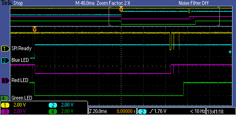

This is how things look on the scope.
The green LED signal indicates the ADC readout procedure, the red LED indicated entering the sleep mode and exiting it again (see above in the source code).
Instead of turning of the red LED when entering Cpu_OnLLSWakeUpINT, it is only toggled, and never turned off.
Case 2: LED on, MCU put to sleep, LED off in same function
If the code for putting the MCU to sleep is changed to the following:

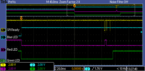

And the scope picture of this event looks like this:
Again yellow is the SPI Ready signal, green shows the whole ADC readout procedure, and red LED signal is the time that the mcu is sleeping.
The one source code line turning off the red LED is the only source code line that was changed in the project.
- In case 1, how come the LED never gets turned off in Cpu_OnLLSWakeUpINT, even though the CPU clearly wakes up from its sleep? Is the Cpu_OnLLSWakeUpINT not executed?
- In case 2, what causes the two spikes on the red led signal, they happen 240µs before the yellow spikes on the SPI/Ready signal?

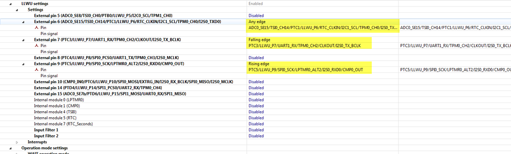

I apologize for the late response, I was working on this issue but I have some problems to understand exactly the issues you are experimenting. Attached you will find an example I created to test this, I will explained later. First I want to give you some hints and ideas when working with LLS mode in Processor Expert and none Processor expert projects.
  • It is not necessary to configure the PORT and GPIO registers for the Pin used as the wake up source. The pin pad is connected directly to the LLWU, then the LLWU is sensitive to the pin changes. This is because the PORT and GPIO registers remain static during LLS mode.
  • In Processor Expert setting the External Pins is enough to say the LLWU that such pin will be a wake up source:
  • When exiting LLS mode the code line before the GoToLLSMode instruction will be excecuted and after that the code will run normally.
