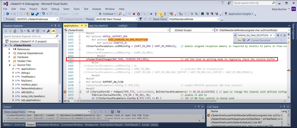

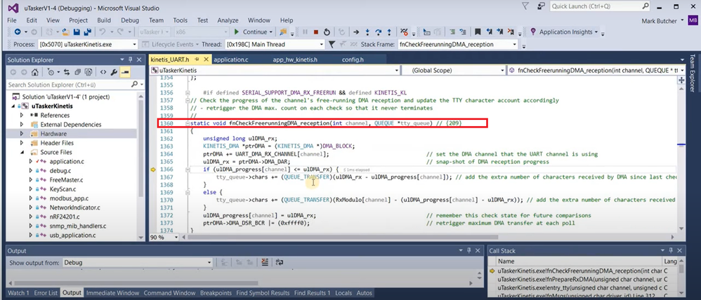

Having looked at the Youtube videos, this still appears to be polling for the number of bytes received (which uses CPU operations) and I cannot see a DMA interrupt for when x number of UART bytes are received.
During the DMA initialisation it is configured for polling...
And the function fnCheckFreerunningDMA_recption polls for the number of bytes received...
When I have used DMA on the Microchip dsPIC, I configured the DMA to generate an interrupt once x number of transfers had occurred.
Therefore no CPU operations were needed until the DMA ISR needed to be serviced, there was no need to keep polling (and therefore using CPU operations) to see how many bytes had been received, the DMA controller took care of all this by itself.

That is correct since it is the FREE_RUNNING_RX_DMA_RECEPTION mode of operation which uses no interrupts.
This is configured with
tInterfaceParameters.ucDMAConfig = (UART_RX_DMA | UART_RX_MODULO | UART_TX_DMA);
and polled with
uTaskerStateChange(OWN_TASK, UTASKER_POLLING); // set the task to polling mode to regularly check the receive buffer.

However, practically, the polling method (low priority task that does this when there is nothing else to do) or a HW timer based (eg. processor set to low power mode generally and checks on HW timer wake-up every Xms) are more practical for situations where the reception data is random/asynchronous of no pre-defined length (Xms set as long as possible for the latency requirement and the buffer length set long enough to be able to hold max. data length between checks).
