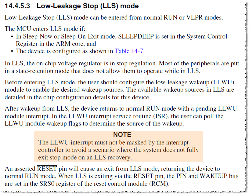

From the reference manual: "NOTE The LLWU interrupt must not be masked by the interrupt controller to avoid a scenario where the system does not fully exit stop mode on an LLS recovery."
The LLWU ISR is required when waking from LLS or VLLSx low-power modes.
We're glad to hear you have the wake-up working now.  Best regards

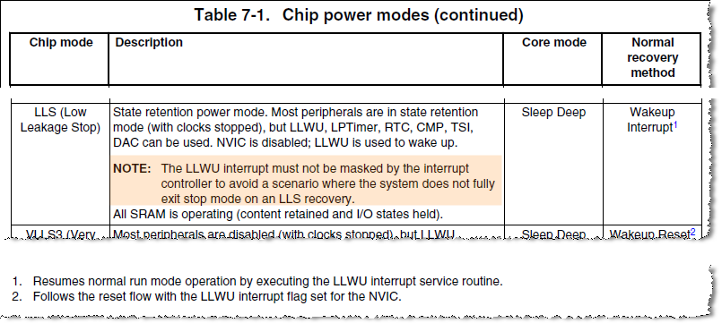

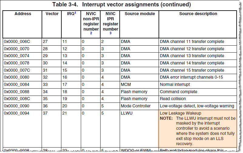

“The LLWU interrupt must not be masked by the interrupt controller to avoid a scenario where the system does not fully exit stop mode on an LLS recovery.”
Robin

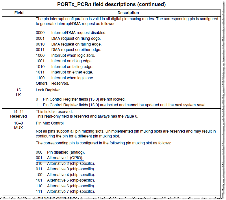

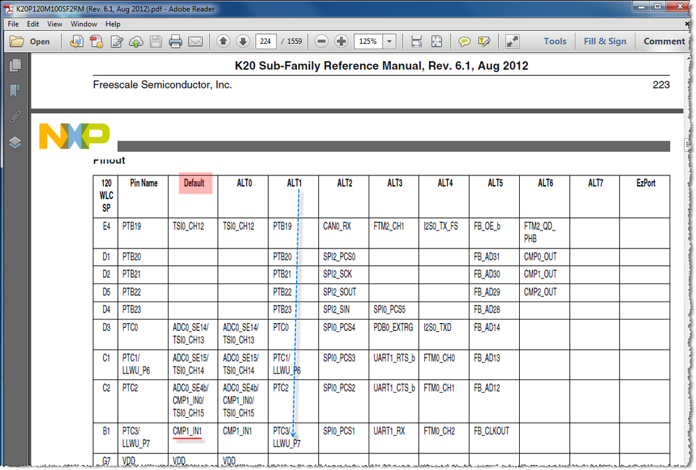

Hi Ryan,
The PTC3/LLWU_P7 pin is default as CMP1_IN1 function.
Have you try to configure PORTx_PCRn[MUX] before using LLWU?
Robin
3,195 Views
ryanlush
Yes. And like I said, it wakes up with this pin when on the debugger.
