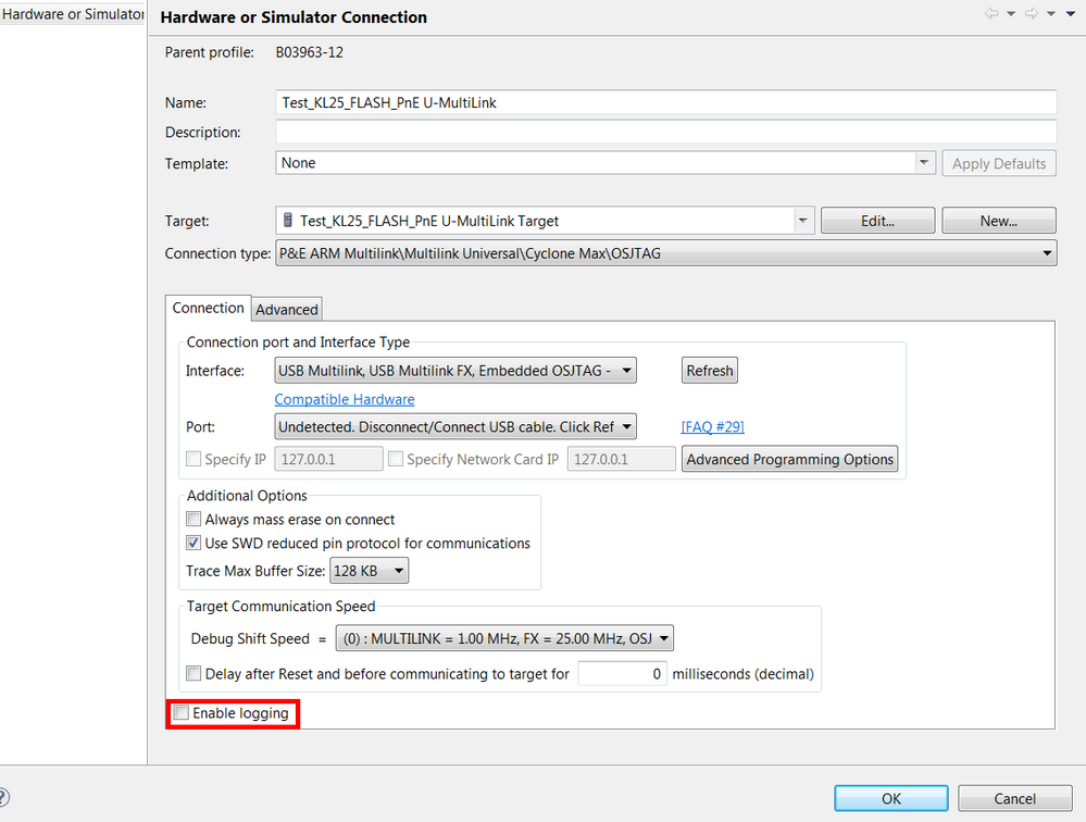

LuisCasado
That problem is not related with your custom board. You can not connect with debugger, not with target.
Ok, Try the following. Use any project working in the FRDM board and verify that you can debug in FRDM. Then, switch to your custom hardware and connect debugger and power the custom hardware.
Force mass erase on connection:
Luis

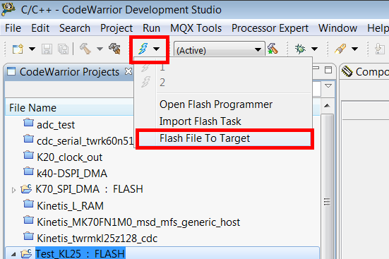

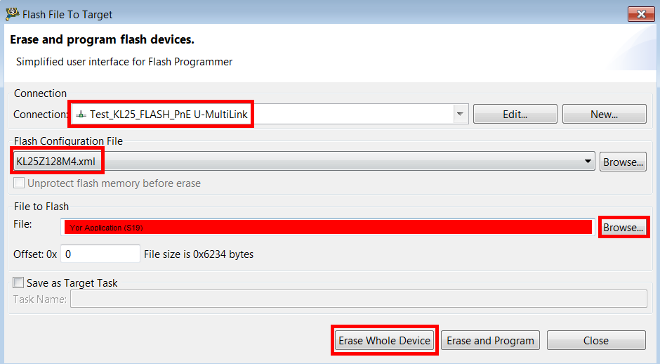

jaluna
Dear Luis,
the problem is (not textual) "unable to connect to target". I don't have tried a "CW flash programmer", where can we find it?
We use CW 10.3
Juan A. Luna

LuisCasado
You can also enable log in the connection to know more about what is happening.
Luis

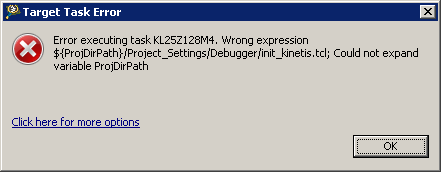

jaluna
Hello Luis,
thanks for your help!
I'm in the task to apply your suggestion. But I get attached error when trying to run the task.
Juan A.
