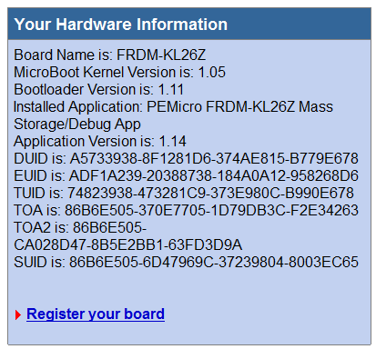

  Here is what the "SDA_INFO.HTM" webpage, located in the mass storage device that comes up, gives me on the KL26Z. It should look the same for you except with a different board name:

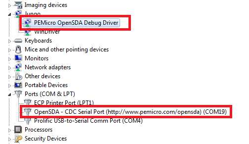

  Here is what it should look like under Device Manager:

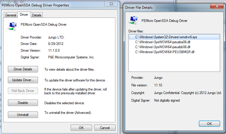

  And in the Driver details for the PEMicro OpenSDA Debug Driver:

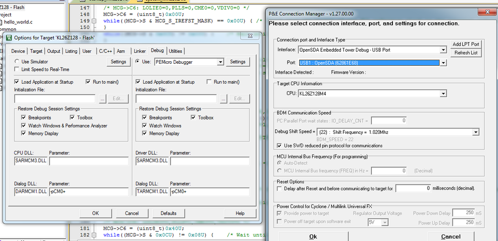

  Here is what the Keil settings should look like:
