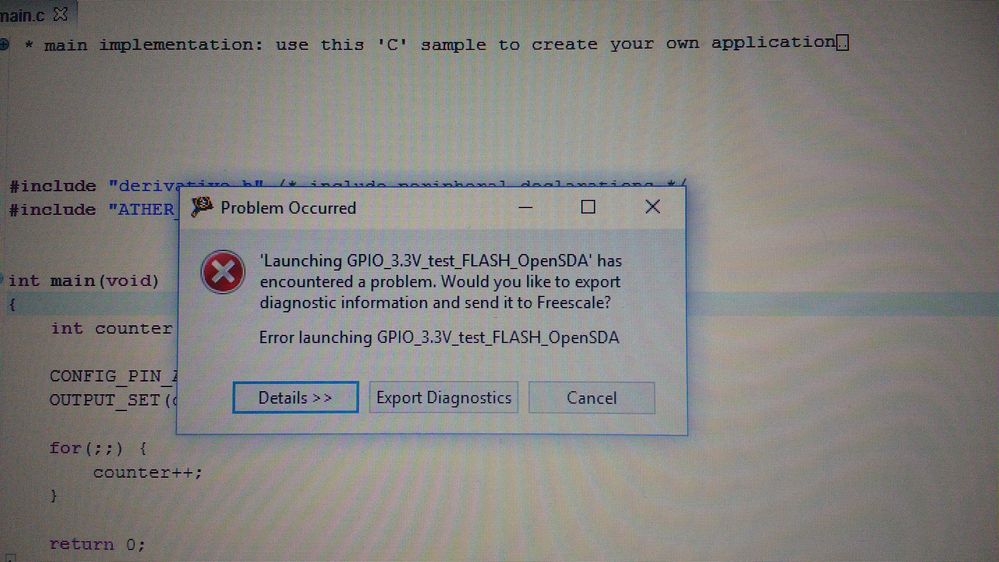

I tried flashing my code by both Open-SDA and J--link segger.But i am unable to flash my code.
It is showing me an error message like this when i flashed my code with J-link Segger
ARM GDI Protocol Adapter : An error occurred while trying to write memory. The Debugger can not write memory.

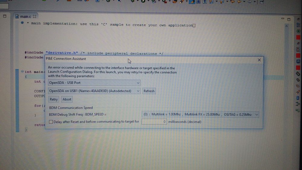

It is showing me an error message like this when i flashed my code with Open-SDA
ARM GDI Protocol Adapter : Can't connect. The Debugger can not connect to the P&E device
Can anyone tell me what is the problem and how to solve this ?

IMG_20151103_160828989[1].jpgIMG_20151103_160844316[1].jpgHi Alice,
I am using Code Warrior IDE
I tried a very simple program makiing a GPIO as high.It didn't work.
I hav attached the code and the pictures of it

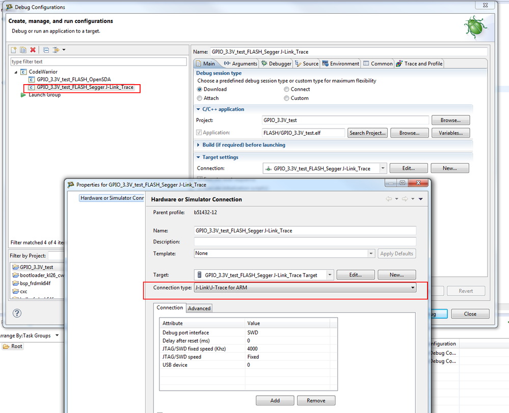

Hello ,
I have test your project on my side , it can work well.
Please select segger J-link, like this :
You can it can work well on my side :
Hope it helps
