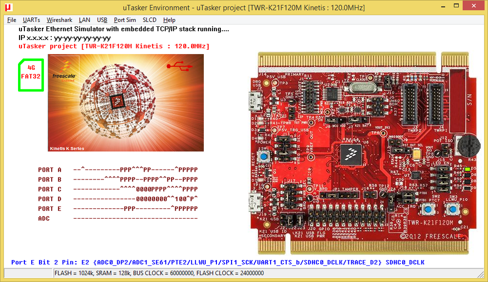

Should this not match your board you can also tell me what crystal it has instead since I can build for most combinations and simulate them. Below is the simulation of the K21F120 board as reference. The USB stack and drivers are HW independent and so don't suffer from any porting difficulties (operation on all KL and K parts is ensured) and the USD device support is extremely flexible since it allows combining classes into composite device with no effort at all (one just selects which classes are to be used and the number of CDC interfaces, when included, and the project adapts itself automatically).
