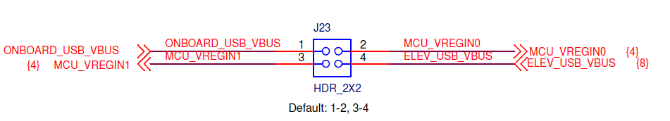

Hi  Hao
The TWR board is in default state, which means that J9 is shorted 1-2 and 3-4.  ( VREGIN0 connected to VBUS)
J9 is in the 5-6 position.  Board is hence powered from the K20 mini USB.
This power setup is similar to my custom board.
I find it hard to accept that it should be required to deinit the USB stack prior to disconnecting the cable, for two reasons.
First this would mean that you would have to predict when the user disconnect the cable, and would make it difficult to design as self powered device that allows usb to be reconnected.
Secondly the setup based on the reference source code seems to work with the 16 MHz XTAL mounted on the TWR board, but not when a 24 MHz XTAL is mounted. For the reference project the stack is only initalized during startup and i not reinitialized on reconnect. However USB reconnects work as expected when runnning of 16 Mhz XTAL.
/Anders

cutworth
Hi Anders,
The board setting on your board is still different from what is on K65 tower board. On K65 tower board, you are not connecting VREGIN0 and VREGIN1 together, but on your board, they are connected together. I suppose you are not connecting TWR K65 in tower assembly so ELEV_USB_VBUS is 0V, right?
There is one errata related to current limiter behavior of USB regulator when the VREGINx pins are different voltage. This may cause temporary VREGOUT drop. I am not sure if this is related to your issue. When you say 24MHz clock input does not work and 16MHz clock can work, what did you see on PC host? Is it USB enumeration fail?
http://www.nxp.com/assets/documents/data/en/errata/KINETIS_K_0N65N.pdf
For self-power case, you can still power USB regulator to keeping USB PHY always working. You can connect VREGINx to 5V on your board instead of from VBUS or you can connect VREGOUT directly to 3.3V with VREGINx floating.
Hao

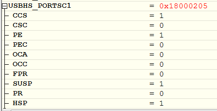

aescov
Hi Hao
After having the device connected to a USB analyzer i can confirm that the USB TX part is not not working after reconnect.
From debug traces from my device and the USB analyzer i can see that the reset and GetDeviceDescriptor commands are received by my device, but the answers does not get onto the line, even though the date are copied to the endpoint.  The host retries GetDeviceDescriptor command a number of times before reporting unknown devices.
Another observation is that when connecting the cable again after having disconnected with controller and phy active the 1.5K pull up on DP seem to be on forever on.  Also i cannot control the pull up with the  USBCMD->RS bit as expected.
The only way i have found to recover from this state, is by entering a stop mode  (VLLS0/1). Then after wakeup the USB blocks are working again and enumeration succeeds. In some use case this will be feasible but i don't find this to be a very nice and probably not one that  generally can be used in the product.
Are the any reliable way to reset the USB block apart from the reset bits in the software reset bits in USBCMD and USBPHY_CTRL
Hope this additional observation will help finding a solution.

cutworth
Hi Anders,
I do not quite understand the part you say 1.5k pull up always enabled after disconnect and reconnect. HS USB works at first as FS device and with 1.5k pullup enabled, then it goes through high speed handshake and remove the pullup. So you mean you never see the high-speed handshake on USB bus?
