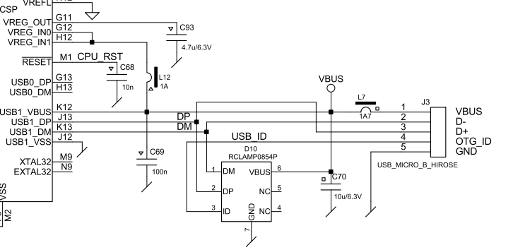

I am using the stack that is supplied with the KSDK 2.0.  By the way I recently tried to generate a new SDK with MCUXpresso generator, to see if anything was updated, but it did not include the USB stack for the K26.
The USB part of the schematics looks like this.
As described the reconnect issue is not present  on all units, and does not occur at all if I manually deinitializes the stack prior to disconnecting the USB cable. When the unit is in error state i am not able to recover until i reset the k26.
/Anders

K26 is in same family as K66 or K65, so you can refer to either FRDM-K66 board or TWR-K65 board SDK package.
When you remove VBUS power, both VREGINx are off based on your connection and VREG_OUT will not provide 3.3V any more and this will cause USB PHY unlock and USB controller in incorrect state, that's why you need to deinitialize USB stack before disconnecting USB cable. You have used some GPIO to detect VBUS, right?
