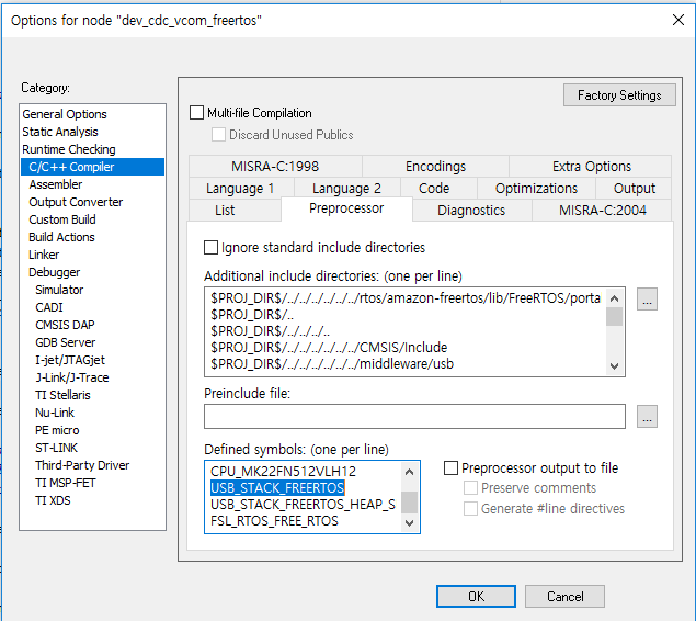

i have got error on USB example code porting.
the error is belows..
Fatal Error[Pe035]: #error directive: Not define RTOS in file "usb_osa.h". D:\<directory>\FRDM-K22F\SDK_2.5.0_FRDM-K22F(RTOS)\middleware\usb\osa\usb_osa.h 96
error cased by there is no macro definition. (usb_osa.h)

So, i try find out one of macro in sample project(freeRTOS, NON OS), it can be compiled.
USB_STACK_BM, USB_STACK_FREERTOS, SDK_OS_BAREMETAL, SDK_OS_FREE_RTOS, ...
But, I couldn't find it anywhere. I can't understand how a sample project can be built successfully.
where can I find this macro definition ? .

shkim9
I found it !.
the macro defined preprocessor options.

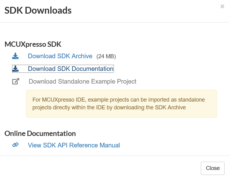

shkim9
Hi.
I referenced document "MCUXpresso SDK USB Stack User's Guide" chapter 3 "porting to a new platform".
This document generated by "MCUXpresso SDK builder" web app.(https://mcuxpresso.nxp.com/en/welcome)
I did not know where the definition of the "USB_STACK_FREERTOS"(because my project use freeRTOS) macro was when I ported it.
Except for this problem, it works by just copying the sample code. ( Of course, you should remove the main function in sample code, and have some porting works.)
