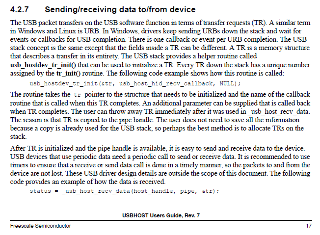

Kan_Li
The functions used for sending and receiving any message by USB should be usb_hostdev_tr_init() and _usb_host_recv_data(). Please kindly refer to the following for details.
For more details, please refer to USBHOSTAPIRM.pdf and USBHOSTUG.pdf in "C:\Freescale\Freescale USB Stack v4.1.1\Documentation".
Hope that helps,
B.R
Kan

robertofrechill
Thanks Kan, i know this information, now i´m able to read data from device i´m thinking the problem is when i try send a message to device the setup packet is wrong for my device...
