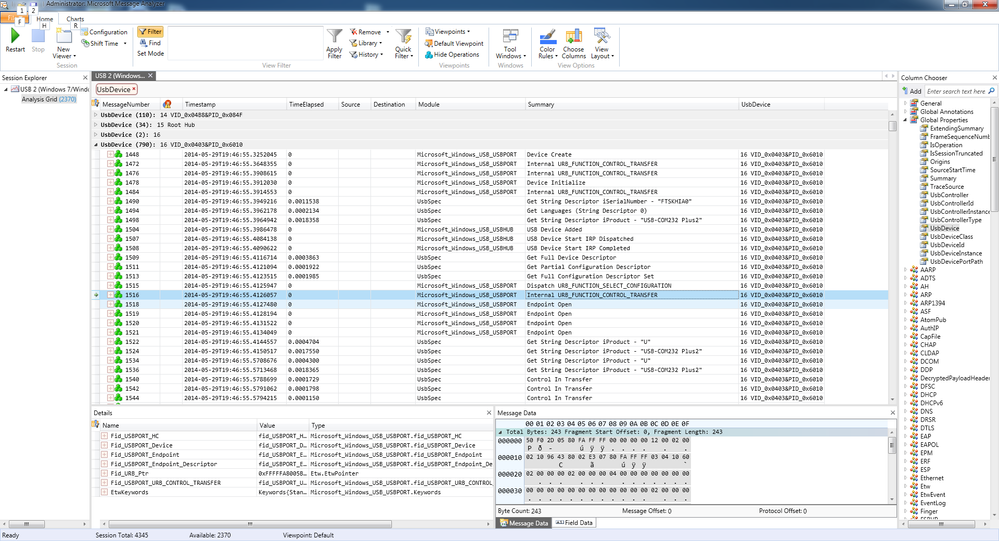

I've since downloaded the Microsoft Message Analyzer tool to try and help diagnose whats going on. To be honest, I don't really know what I'm looking for but as far as I can see, everything appears to be normal - no errors are highlighted.
Here is a screenshot of the message trace.
I guess the next thing to do is to compare it to another USB to serial device, such as an FTDI board I have.

So technically, I'm not comparing apples to apples but I think the test is good enough. Here's a capture of the FTDI trace and there's a lot more stuff going on.
For a start there is an "Internal URB_FUNCTION_CONTROL_TRANSFER" which happens immediately after the "URB_FUNCTION_SELECTION_CONFIGURATION" which happens to be the last message in my non-working trace.
Could this then be an issue with the Freescale USB stack? Anyone from Freescale able to help with this?

Unfortunately, I don't have a hardware USB analyzer but I do have a software one which I've been using however I'm still unable to determine the root cause. Enumeration doesn't seem to complete successfully however the USB_ISR enters as I expect it to.
Good idea about getting a much simpler project up and running - I guess when I initially designed the K22 into my project, I had hoped for a few more examples from Freescale but like you've mentioned, the K21 is almost identical.
Thanks for the link, I shall give the uTasker demo a try although admittedly, I've never used uTasker before so I may be in touch with further questions.
