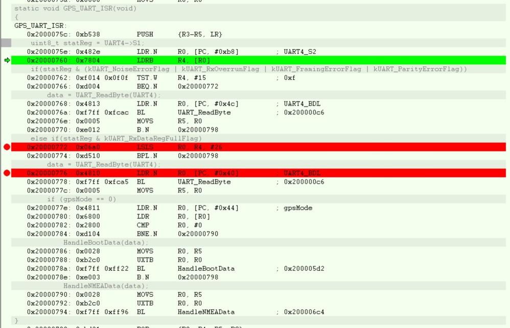

ryanlush
I have a break point on the first line of the handler, before reading the S1 status register and can see the value is 0xF4. I'm not sure why the noise flag is set, things look really crisp on my scope which is on a test pad right next to the chip.
But anyways, the value stored in statReg is 0xC0. I didn't think the value of S1 was supposed to change until I read the data register. I've attached the assembly code for someone smarter than me to explain (please?).
