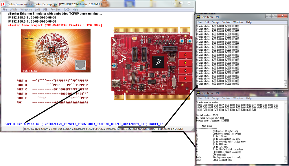

I set this up in the uTasker Kinetis simulator as show below - it simulates DMA and the UARTs so also makes it easy to test and identify any errors. I simply configured for your board, added a UART open for your UART with the DMA mode enabled, checked the full operation in the suimulator and finally loaded to the TWR-K60F120F board where it also did as was expected.
Mark
Note that the simulator shows the pin mux that have been set so it is simpole to verify that the code hasn't set anything up incorrectly.
The main clocks and UART speeds are displayed in the status line, giving feedback that these are all set as expected. The 2 UARTs are connected to virtual COM ports on teh PC so the operation can be tested in real-time (as the Ethernet can).
The TWR-K60F120 board is being simulator (LEDs blink when connected to the right outputs and switches are reacted to.
The accelerometer and I2C are also simulated but the values read are 0, as seen above. On the real HW there are values depending on actual orientation.
