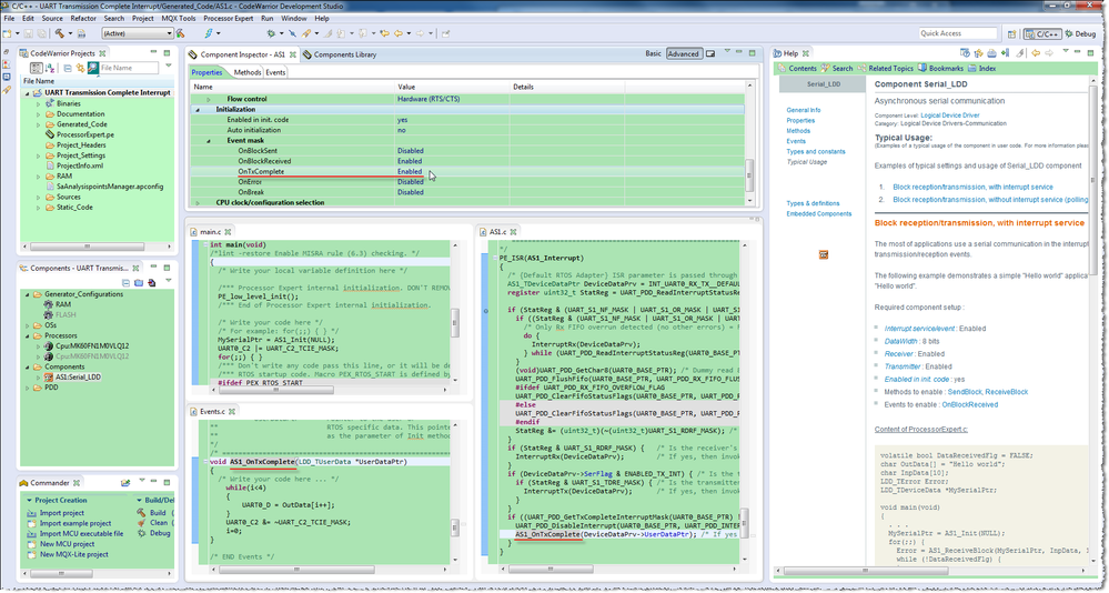

I have a TWR-K60F120M Board and my problem is the uart interrupt routine.
In my main i created an array with 4 numbers
int a[4]={1 , 2 , 3, 4};
UART0_C2 |= UART_C2_TCIE_MASK;
i wanted to start the interrupt with the transmission complete flag
In my interrupt routine
extern int a[];
int i =0;
void UART_IRQ
while(i<4)
UART0_D=a[i];
i++
UART0_C2 &= ~UART_C2_TCIE_MASK;
i=0;
I don't receive the numbers from the uart and i don't know why .
Maybe someone know where i'm mistaken.

You can refer the attached test project. I test it on TWR-K60F120M board with CodeWarrior10.7.
Robin

I think you need to use the transmit data register empty interrupt to start transmission like this (the complete interrupt is set after the final bit of a character is sent).
Also you need to send one byte at a time and wait for the output FIFO to be free before sending the next (depends on the FIFO depth).
Attached is the uTasker UART driver as reference which allows interrupt and DMA operation on all LPUART and UARTs.
To save time just use the uTasker K60F120 Open Source project which includes all that you need, is documented and allows the K60F120 to be simulated, including UART interrupts/DMA.
Complete code is available at http://www.utasker.com/forum/index.php?topic=1721.msg7086#msg7086
