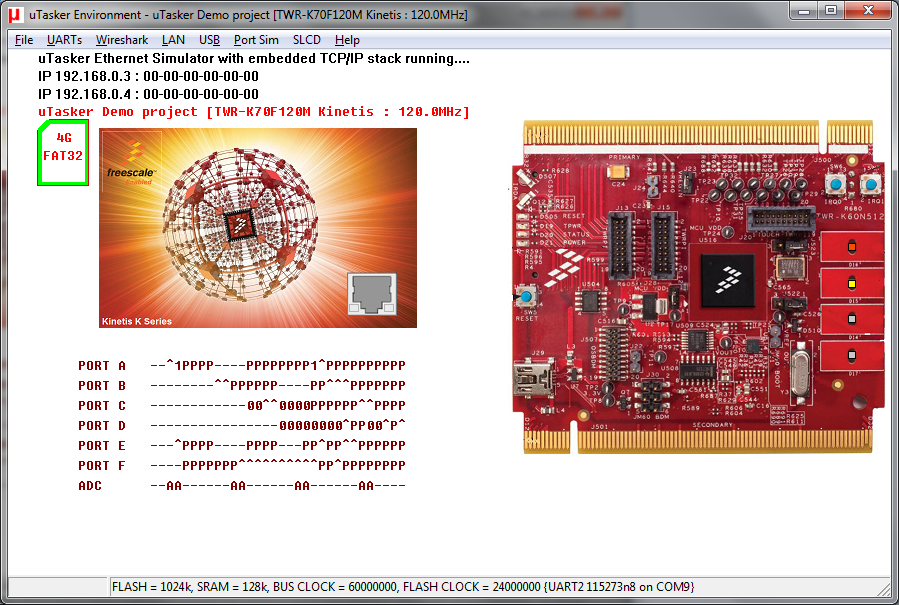

The UART on TWR-SER and TWR-K70F120 is UART 2 and the pins to use are PTE16 (TX) and PTE17(RX).
You can get out-of-the-box code for this tower kit (UARTs in interrupt or DMA mode, TCP/IP and USB stack as well as FAT on SD card etc.) as well as a simulator for the K70 tower kit at http://www.utasker.com/forum/index.php?topic=1721.0
A screen shot of the simulator in operation is shown below.
