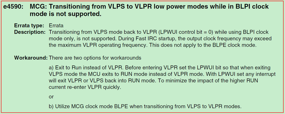

There is an errata record about K10_50MHz product VLPS mode, please check below picture for the detailed info:

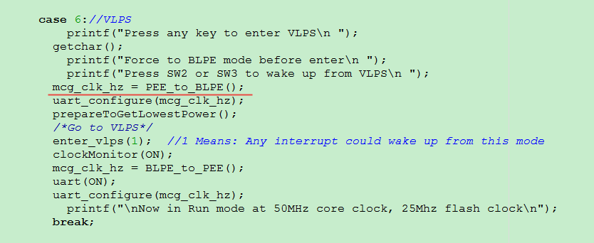

According to this errata, I would recommend customer to refer below code to enter into VLPS mode:
You could get the full software project from [Kinetis 50MHz bare metal sample code(REV 1.6)]
Wish it helps.

Thanks for the reply. Actually in our case the transitions from
Run to VLPS, and
VLPS to Run.
I'm able to wakeup k10 with UART interrupt, however with TSI, K10 remains in VLPS, doesn't matter what are the configurations.
