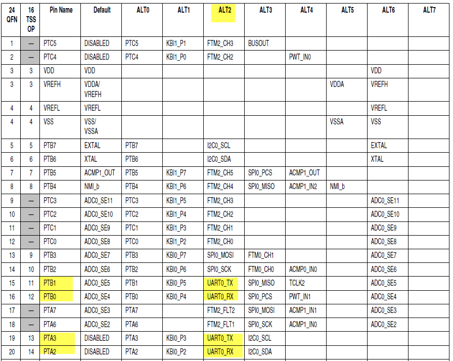

We want use UART for serial communication with GPS chip on KEA8 micro,Prot pins PTB0 and PTB1 are assigned for UART as ALT4,do we need to make any specific setting to use ALT4 functionality on port pins.

KEA8's UART0 is ALT2 on PTB port (not ALT4)

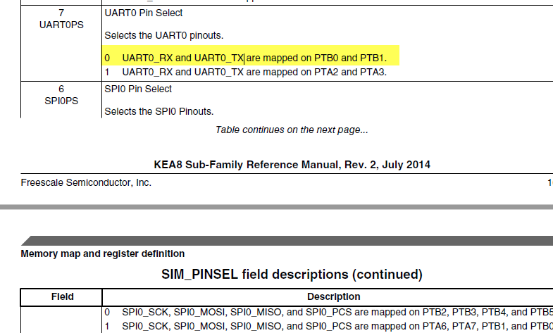

To use the alternative pins on port A instead this would have to be selected with
SIM_PINSEL0 |= (SIM_PINSEL_UART0PS);
and then the pins with
_CONFIG_PERIPHERAL(A, 2, (PA_2_UART0_RX | UART_PULL_UPS));       // UART0_RX on PA2 (alt. function 2)
_CONFIG_PERIPHERAL(A, 3, (PA_3_UART0_TX | UART_PULL_UPS));       // UART0_TX on PA3 (alt. function 2)

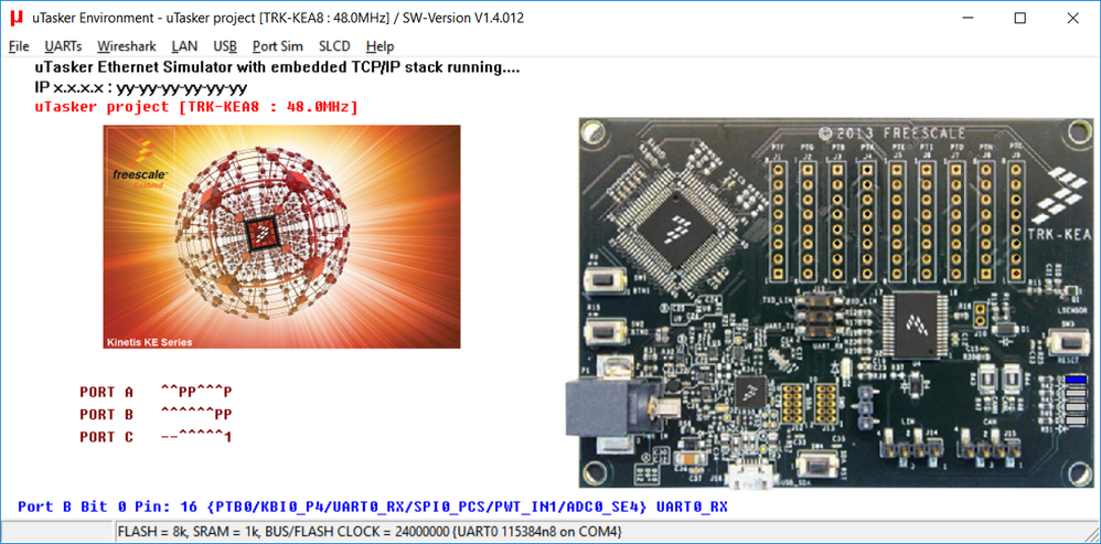

Simulation below showing the Rx pin function being checked.

    I don't know why you say the KEA8 PTB0 and PTB1 are assigned for UART as ALT4, from the KEA8 reference manual:
https://www.nxp.com/docs/en/reference-manual/KEA8RM.pdf
 page 134,
You can find the PTB1 and PTB0 ALT2 is the UART0 pin.
You don't need to configure the ALT, if you enable the UART, but didn't enable the higher priority module in this pin(AL3,ALT4,ALT6 module), the PTB1 and PTB0 will default in the UART function after you enable the UART0 module.
About the UART0_TX and UART0_RX detail, it is configured in register SIM_PINSEL[UART0PS],
in default, UART0 pin are mapped on PTB0 an PTB1.
