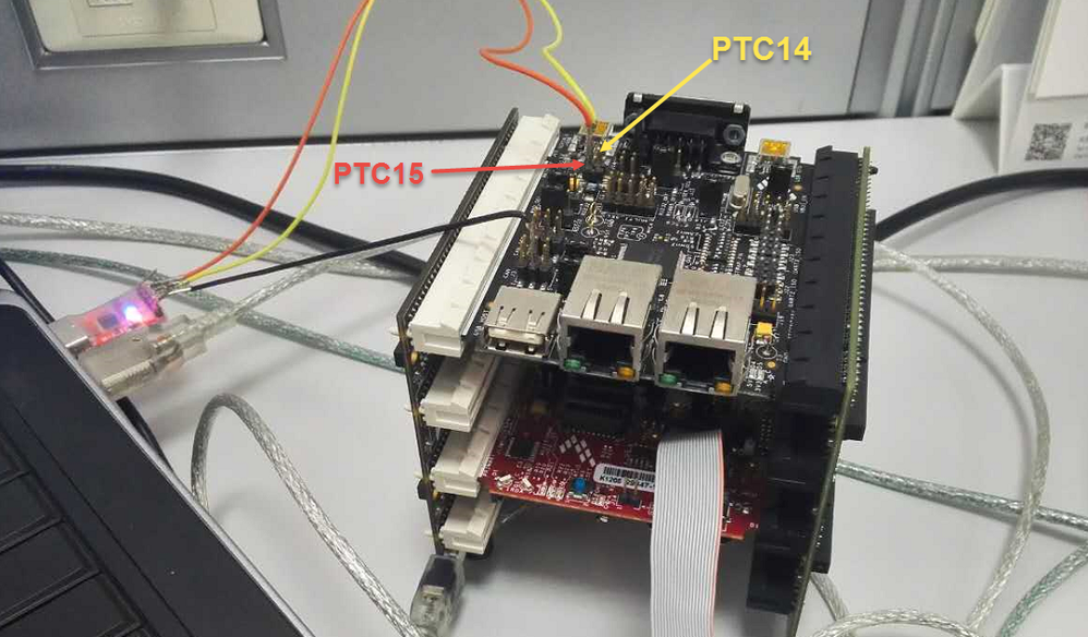

Hey Guys,
I'm trying to develop an UART Connection with the TWR-k53n512 TowerSystem. I use the Pins A41 and A42 from the Expansion Port for the UART 4.
My Code i use:

Now my Problem, i just receive junk in my terminal.
Line 17 and 18 gave me: "00 F0" and "00F0".
Line 20 and 21 gave me: "0E 3E FE" and "0E 3E FE".
So has anyone a clue for me?
EDIT:
OK, it works!?
uart_init(TERM_PORT, 50000, 300);‍
When I change the baud rate in the code to 300 and the baud rate in my terminal to 600 it works. I receive the right data. It seems that I don't understand the baud rate or  the code correctlySmiley Sad.

smaschy
After the post from Hui_Ma I figured out that it was a hardware problem. The oscillator was broken.

Hui_Ma
I using your attached UART software and made some modification,which works with TWR-K53N512 board and TWR-SER2 board (For customer wants to use PTC14 and PTC15 pins). I attached the updated UART software code for your reference.
Please check below serial terminal print info:
Below is my test environment:
Wish it helps.
Ma Hui

Hui_Ma
Customer need to check the external 50MHz clock source from TWR-K53N512 board or TWR-SER board .
Then customer need to check related jumpers setting.
And customer also can set K53 PTC3 pin ALT5 function is CLKOUT, which could be used to measure the bus clock frequency.
I think it was the hardware issue,no the software.
Please check your hardware platform.
Wish it helps.
