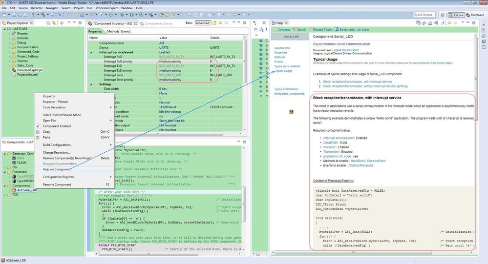

Anybody know how to use uart3 interrupt in k53 series MCU?How to enable it and set the priority?
1,271 Views
Robin_Shen
Hi Remya,
I am using the Processor Expert in KDS3.2.0.
You can refer the Typical Usage of Serial_LDD, for example "Block reception/transmission, with interrupt service".
Also you can select the interrupt priority what you want.
