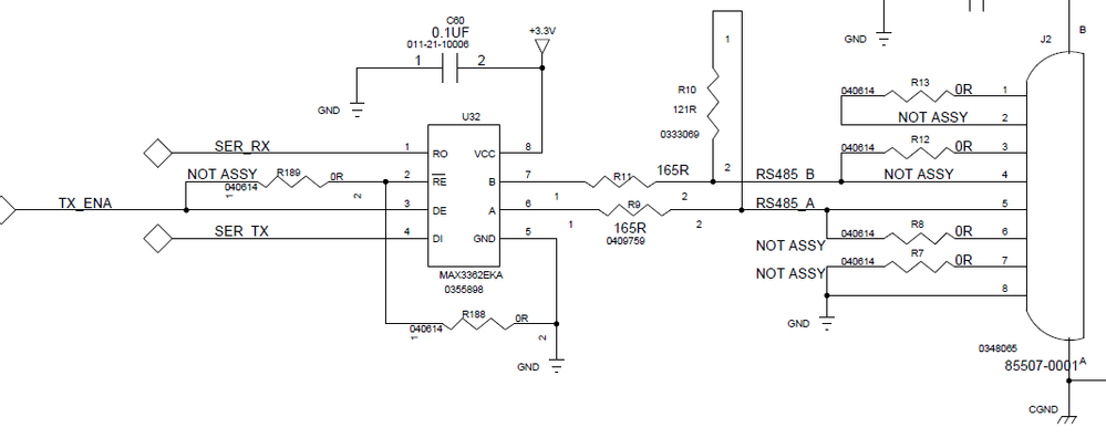

From looking at various posts, I've understood there is no HW flow support for UART. I'm working with KSDK 2.1 (I've read no support for earlier versions).
Nevertheless, in MK64F12.h there's:
/* @brief Hardware flow control (RTS, CTS) is supported. */
#define FSL_FEATURE_UART_HAS_MODEM_SUPPORT (1)
1. So, does it mean there is HW Flow support?
2. How do I use it?
I  connected TX_Enable to pin 71, PTC1 (UART1_RTS), still I do not get any uart interrupt... (Where as in FRDM board all is ok). I defined this pin to be a UART1_RTS functionality)
Any idea?
Update:
See more info below. It seems the RTS is high (even though I tried changing its polarity), and by that avoiding data from being received by the chip. Mystery....
Roy

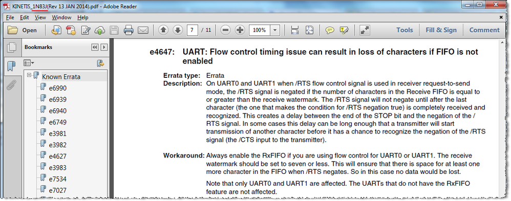

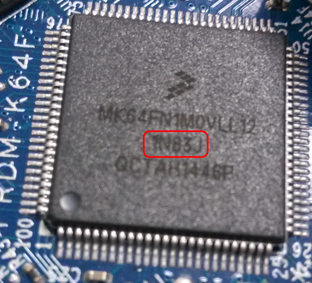

Robin_Shen
If your project works flawlessly on the FRDM board but not with my custom board. Are there any difference between FRDM board and the custom board?
Have you check the mask of the MCU on your custom board?
For the 1N83J mask, e4647: UART: Flow control timing issue can result in loss of characters if FIFO is not enabled
About the Hardware flow control, you can refer the uart_txrts_test() in attached "uart_flow_control_tests.c"file.

roymessinger
Contributor V
Thankd Robin & Mark. Once I've swapped between R188 and R189 like a typical RS485 half duplex comm. it all went fine and all is working.
Thanks for the test file. I will keep it... ;-)

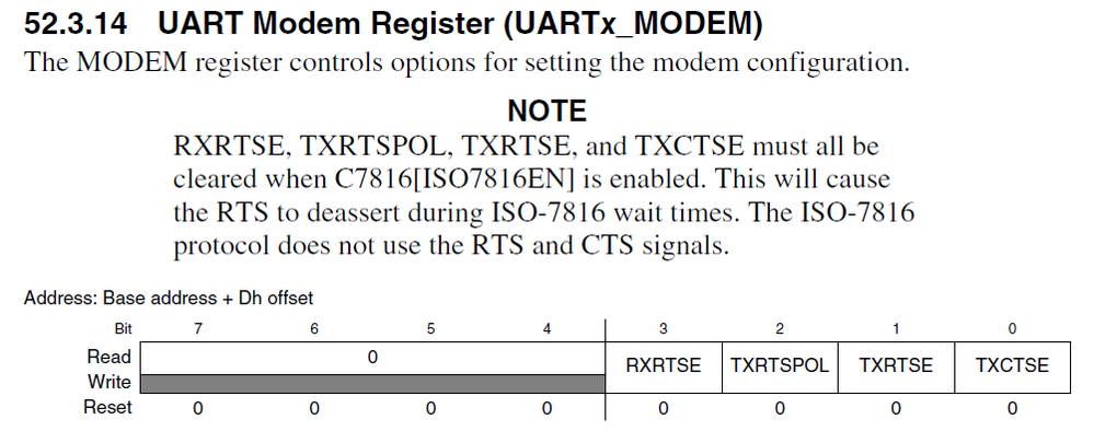

The K64 has a modem register which controls some part of RTS/CTS HW flow control automatically.
Eg. Set TXCTSE in UARTx_MODEM register and it will only send when the CTS input is asserted.
You can control the RTS output with the RXRTSE bit in the same register.

mjbcswitzerland
Specialist V
I think that the subject is in fact RS485 mode rather than HW flow control since you are using the RTS to control the transceiver's drive. This is described in Chapter 8 of the document that I linked to.
The code to do it is very simple since this is automatically controlled by the UART.
_CONFIG_PERIPHERAL(C, 1, (PC_1_UART1_RTS));
UART1_MODEM = (UART_MODEM_TXRTSE | UART_MODEM_TXRTSPOL);
Mark

mjbcswitzerland
Specialist V
Roy
UART1->S1 & UART_MODEM_TXRTSPOL(1) | UART_MODEM_TXRTSE(1);
This code looks to have nothing to do with setting the mode.
Why are you using the status register rather than the MODEM register?
If this is the real code it is just reading the status register and masking it with 0x06 which doesn't write anything to any register.
1. Write the value directly in the MODEM register in the register view and test the operation first so that you have a working reference.
2. Then write code to set the bits correctly. If you are having problem with the macros in your framework you can also simply do:
*(unsigned char *)0x4006b00d = 0x06;
