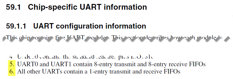

using EmbSysRegView in Processor Expert, I suspect the UART{0,1} RX/TX FIFO size on my part (MK65) is 8 Byte. The other UARTS don't have a FIFO.
in what documents from Freescale can I find such information?
The Datasheet is not giving a single search hit for "fifo"...
and the reference manual states " See the Chip Configuration details for more information on the FIFO size supported for each UART instance"...
Where is this frequently referenced "Chip Configuration details" Document???

Hello Peter:
The FIFO sizes are defined at the beginning of the UART chapter in the Reference Manual, in points 5 and 6, see below:
Regards!,
Jorge Gonzalez
