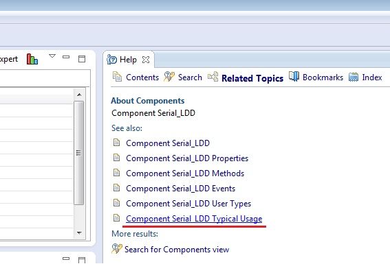

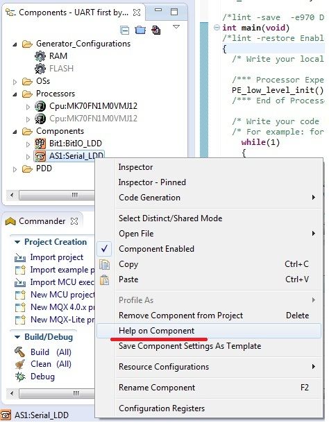

Robin_Shen
I write a sample code with PE in CodeWarrior10.5 according to Component Serial_LDD Typical Usage "Block reception/transmission, with interrupt service ".
I use the TWR-K70F120M board , uart2 TxDpin=PTE16  RxDpin=PTE17,Baud rate=38400.
Every time you send a 'e' to RxDpin,the TxDpin will send out 'Hello world' and toggle Green LED(PTA29).
Hope it help
