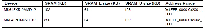

I found in the MQX 4.1.1 linker the following definition:
MEMORY
    vectorrom   (RX): ORIGIN = 0x00000000, LENGTH = 0x00000400
    cfmprotrom  (R): ORIGIN = 0x00000400, LENGTH = 0x00000020
    rom         (RX): ORIGIN = 0x00000420, LENGTH = 0x000FFBE0  /* Code + Const data */
    ram         (RW): ORIGIN = 0x1FFF0000, LENGTH = 0x00040000  /* SRAM - RW data */
In KDS 1.1.0 is the definition:
MEMORY
  m_interrupts          (RX)  : ORIGIN = 0x00000000, LENGTH = 0x00000400
  m_flash_config        (RX)  : ORIGIN = 0x00000400, LENGTH = 0x00000010
  m_text                (RX)  : ORIGIN = 0x00000410, LENGTH = 0x000FFBF0
  m_data                (RW)  : ORIGIN = 0x1FFF0000, LENGTH = 0x00010000
  m_data_2              (RW)  : ORIGIN = 0x20000000, LENGTH = 0x00030000
Is the KDS linker file the better definition, because the K64 SRAM is twofolded in a 64kb RAM and a 192KB RAM? What exactly is not allowed at the border of the two RAM areas?
Best Regards
Tags (2)
2,665 Views
Jorge_Gonzalez
Hello Andreas Schmidt:
For K64 the size of the RAM is different between K64FN1M0 and K64FX512:
You are right that the linker file of KDS is a more accurate definition of the RAM partitions. There is no problem on joining both RAM spaces in only one, as long as you make sure that no memory object is allocated crossing the 0x2000_0000 boundary, because the access would cause a hardfault.
The exception to this rule would be an object that actually crosses that border, but the access is to either the SRAM_L or SRAM_U parts of the object, but not a combination of both, I hope I am clear with this.
Regards!,
Jorge Gonzalez
