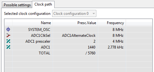

Before we used FEI (FLL output clock from LSI), but now we use PEE (PLL output clock form HSE) which is much better, faster, stable... BUT when we used FEI there were no problem like this. It started with the PEE option of the clock.

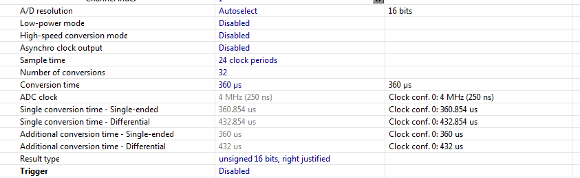

Also I find out that I have no problems when the ADC is 16bit resolution, with 8MHz clock (180us conversion time...), BUT with 4MHz or 2MHz ADC clock or with any frequency when the ADC is 12bit resolution I have these random results.
About the code:
The MCU frequency is 100MHz.
The ADC gets its clock from the HSE(8 MHz) and then divides it with a prescaler...

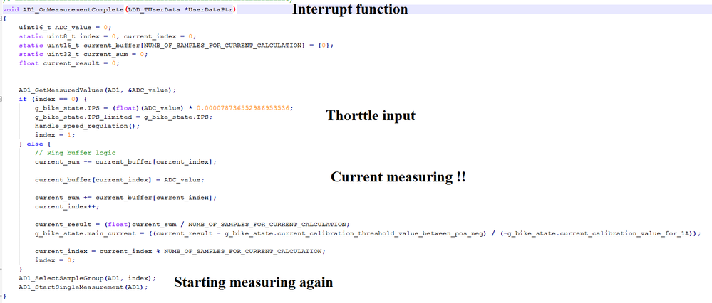

The ADC measurement is initialized in the beginning, after that when the measurement is done, the interrupt AD1_OnMeasurementComplete is called (it has the highest priority in the system). In this same interrupt the conversion from ADC value to current representation is done, and at the end the ADC measurement is started again.
Also I tried using StartCalibration function but it does not help.

I tried different frequencies(2MHz -> 8MHz) and resolution(12bit,16bit) but ALMOST (with 8MHz and 16bit no problem - mentioned before) in every case I have this "random" problem. I designed the hardware in a way that I have an offset that gives me the possibility to sense current in both directions.

Here are the settings of the ADC + the code:
But I also note that when I change the source clock of the ADC, from extern oscillator(8MHz) to BusClock then I have no problems with this "random" issue, regardless of the frequency or the bit resolution. Below is the settings of the source clock set to BusClock:

I have checked your code, you start the ADC conversion in ADC ISR, maybe it has issue, because the ADC conversion rate is too high.
I suggest you use PIT to generate an interrupt, which you can set the ADC  sampling frequency with, in the PIT ISR, you can start the ADC to convert, in the ADC ISR, you just need to read the ADC sample and compute based on your application.
Pls have a try.
