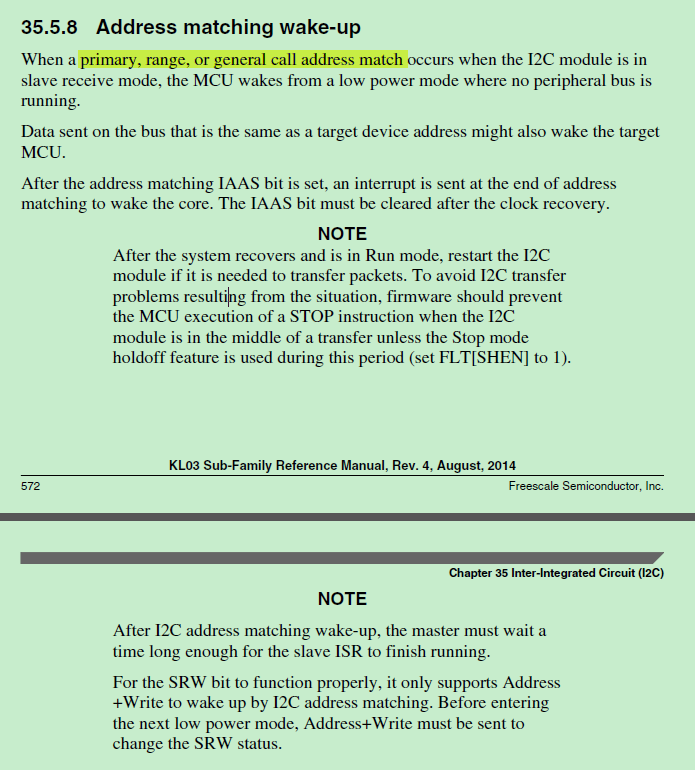

I am having difficulty getting a KL03 slave to wake up from VLPS mode when using 10-bit I2C.  The microcontroller wakes up just fine on address match in 7-bit I2C.  I also have communication working using 10-bit I2C in VLPR mode.  The IAAS interrupt fires using the 10-bit/VLPR, 7-bit/VLPS, and 7-bit/VLPR, but not 10-bit/VLPS.  Is 10-bit I2C not available in VLPS mode?  Or is there something else that needs to be done to get it to work.  Thanks!

Hi Kyle Dickerson,
   From the reference manual description:
It just describes the primary address, no extended address, maybe it doesn't support the 10 bit wake up, but is not sure, I didn't test it before.
You can send me your test project, when I have time, I will also check it on my side. After reproduce it, I will check it with our according department.
Kerry
1,607件の閲覧回数
kyledickerson
Unfortunately I am unable to send you my project.  My workaround is to set the KL03 slaves to 7-bit addressing, then have them switch to 10-bit addressing on wakeup.  I only have KL03 slaves on the bus so this shouldn't be an issue.  If I have the maximum of 1024 slaves on the bus, the worst that will happen is that at most, 8 slaves will be awake for a very brief time.
