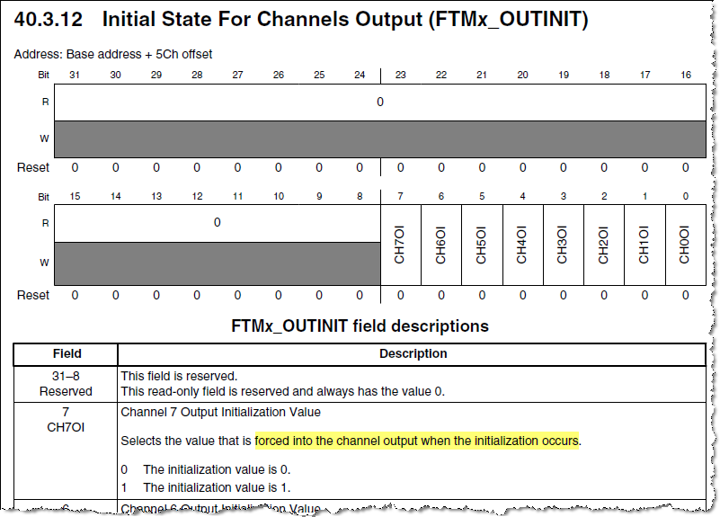

Is it possible to write to the output of an FTM pin on the K64? I have pin A12 set up as MuxAlt4 (i.e. as FTM0_CH1), and am ordinarily using Output Compare to set the pin. However, in certain instances, I would like to manually set the pin to high. Can I treat the pin as a GPIO pin to accomplish this?
I was hoping I could simply write to the GPIO PDOR register for that particular pin (which is PTC2), but doing so seems to have no effect on the pin output level.

Please check the Initialization feature:
