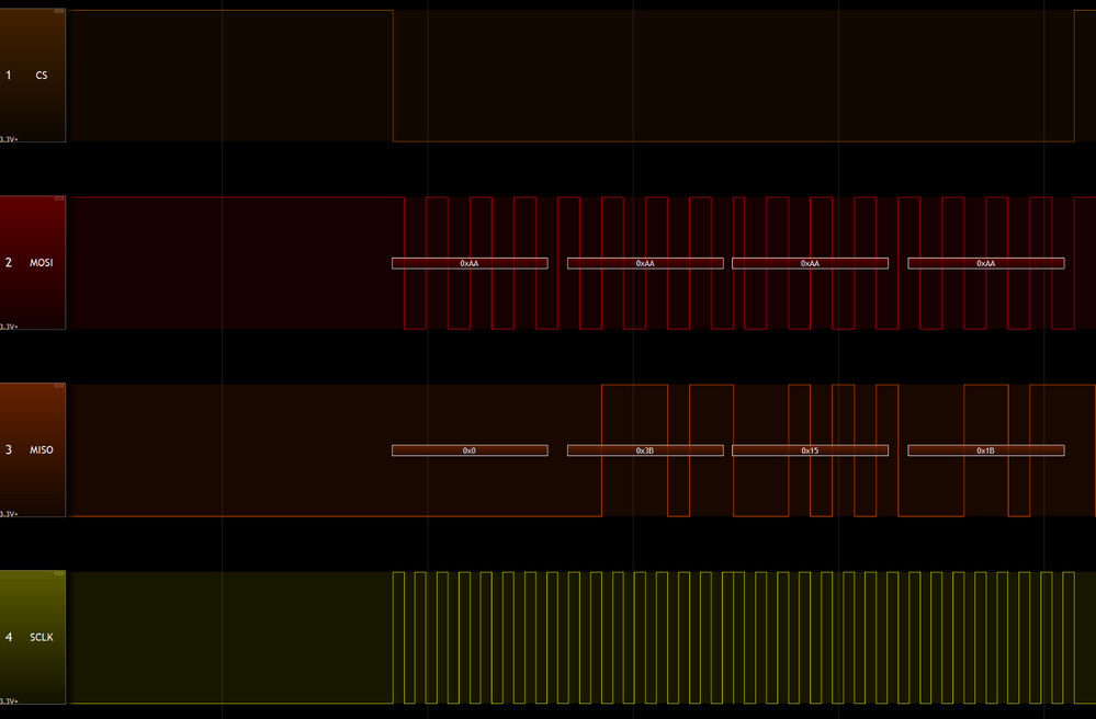

I have got a little question to the SPI configuration. I'm using a MK10DX128VLH7 cpu and would like to communicate
from the cpu to an external AD converter. So there is no problem, I have initialised the spi and there is a function to
transmit  and to receive bytes from the ADC. Now my question:
I have to send 32bit to the adc. So I have to transmit 16Bytes two times. Thats works, but between the last clock
of the first 16bits and the first clock of the second 16bits there is only a very small gap (low time of the clock).
(pls. see the logic diagramm). Does anyone know, how to fix this problem? I don't want to work with external
delay functions... that must be possible, I think..
Thanks a lot!
Pascal

                                                                                       Here is the fault!

The other parameter to look at is ASC or DT in the SPIx_CTARn register.  Even though PCS is NOT to be negated between the two 'transfer parts' (SPIx_PUSHR CONT set), I believe one of these parameters still defines the 'time between transactions'.

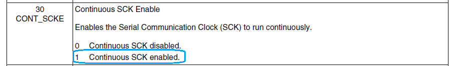

adriancano
You can try to enable the Continuous SCK bit. This is in the SPIx_MCR register.
Check the section Continuous Serial Communications Clock in the reference manual to see the proper configurations when this bit is used
I hope this information can help you.

pascalschröer
Contributor V
Thanks!
I have to set the CSSCK time! Now it works!
