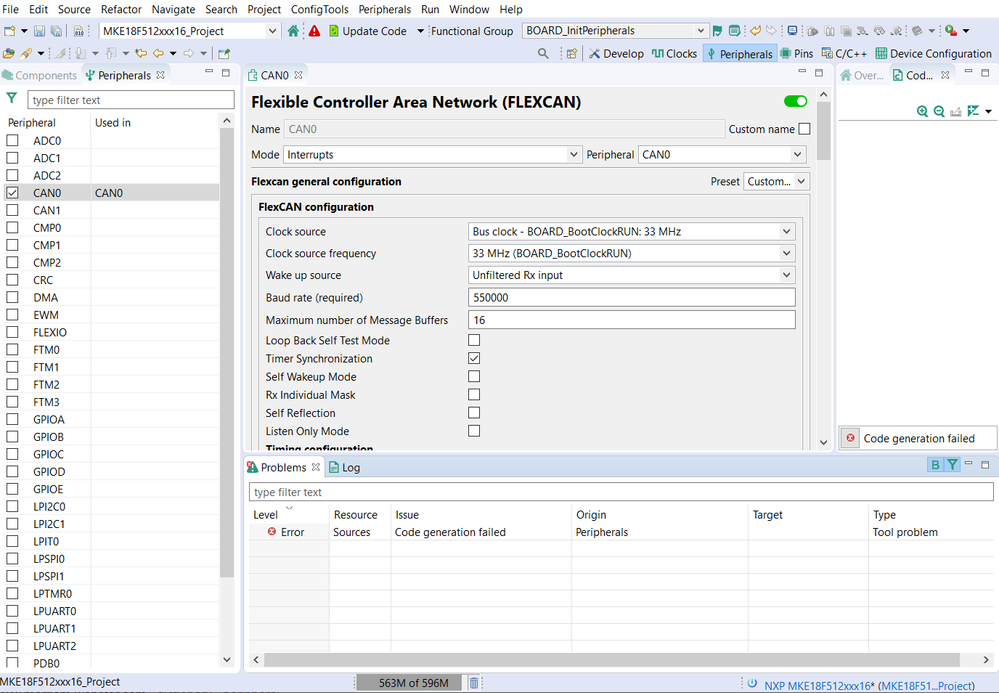

I try to configurate CAN peripheral in "MCUexpresso Config Tools" and I am getting "tool problem" error. The version of the SDK is 2.8.0 and the version of the MCUXpresso IDE 11.2.1. Adsız.png

Hi Randaipek:

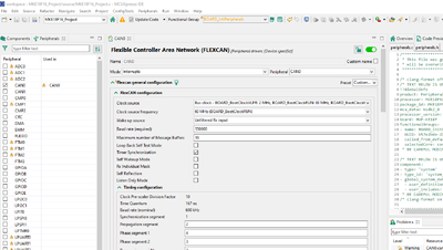

I would suggest you try MCUXpesso IDE 11.3.0,  and latest SDK2.8 from
mcuxpresso.nxp.com
, I tried it on my side, it can work.
MCUXpesso IDE 11.3 can be downloaded from below link
https://www.nxp.com/design/software/development-software/mcuxpresso-software-and-tools-/mcuxpresso-i...
