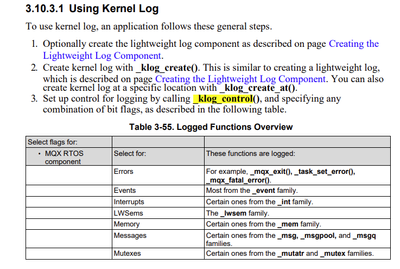

Thanks for your post. According to the MQX_RTCS_User_Guide 5.2 - Jan 2022, "RTCS log entries are written into the kernel log. Therefore, the kernel log must have been created prior to enabling RTCS logging. In addition, the socket API log entries belong to the kernel log functions group in the kernel. To log socket API calls, this group must be enabled using the MQX function
_klog_control()."
Then according to the Freescale MQX RTOS User's Guide
You can go to this directory: mqx\examples\klog  to find the kernel log file.
Hope it can help you. If my answer still not solve your problem, you can try to directly contact [email protected]  for help.

I followed the steps and made some progress.
Now I can see some loggings for interrupts, but nothing from RTCS, even though I have turned on all logging for RTCS.
I have made sure that in user_config.h file:
#define RTCSCFG_LOGGING 1
#ifndef NDEBUG
#define MQX_KERNEL_LOGGING 1
#endif
I built the library in DEBUG configuration.
