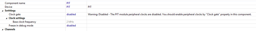

Using PE with SDK1.3 with MKL17Z64VLH4 on custom board.
This is the components warning:
Enabling the clock gate like the description says does not work, it remains disabled.
In fact every disabled item is this component can not be changed.
The Clock manager is using defaults, and this is the first component I tried to use.
Any help would be greatly appreciated.
Rande
1,274 Views
Hello Rande,
You just need click the place of "Disabled" , then choose "Enabled" :
