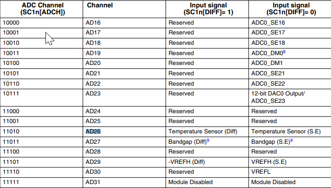

Alexis_A
Hi prashantdev‌,
The temperature sensor should be only in the AD26 only and the AD31 mention that disable the module, if you want to do it single ended disable the SC1n[DIFF].
Also, for more information, check the following document that explains how to convert the measurement to temperature.
Let me know if this helps you.

prashantdev
Thnx Alexis for ur reply.
I'm disabling the channel before calibration. After calibration I've enabled it again.
