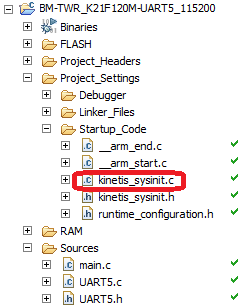

EarlOrlando
Senior Contributor II
Hello again,
Please be sure that your bus clock is at 60 MHz. The code below sets the bus clock at this frequency (it was generated by PEx).
void init_hardware()
    /* Disable the WDOG module */
    /* WDOG_UNLOCK: WDOGUNLOCK=0xC520 */
    WDOG_UNLOCK = WDOG_UNLOCK_WDOGUNLOCK(0xC520); /* Key 1 */
    /* WDOG_UNLOCK: WDOGUNLOCK=0xD928 */
    WDOG_UNLOCK = WDOG_UNLOCK_WDOGUNLOCK(0xD928); /* Key 2 */
    /* WDOG_STCTRLH: ??=0,DISTESTWDOG=0,BYTESEL=0,TESTSEL=0,TESTWDOG=0,??=0,??=1,WAITEN=1,STOPEN=1,DBGEN=0,ALLOWUPDATE=1,WINEN=0,IRQRSTEN=0,CLKsrc=1,WDOGEN=0 */
    WDOG_STCTRLH = WDOG_STCTRLH_BYTESEL(0x00) |
            WDOG_STCTRLH_WAITEN_MASK |
            WDOG_STCTRLH_STOPEN_MASK |
            WDOG_STCTRLH_ALLOWUPDATE_MASK |
            WDOG_STCTRLH_CLKSRC_MASK |
            0x0100U;
    /* System clock initialization */
    /* SIM_CLKDIV1: OUTDIV1=0,OUTDIV2=1,OUTDIV3=3,OUTDIV4=3,??=0,??=0,??=0,??=0,??=0,??=0,??=0,??=0,??=0,??=0,??=0,??=0,??=0,??=0,??=0,??=0 */
    SIM_CLKDIV1 = SIM_CLKDIV1_OUTDIV1(0x00) |
            SIM_CLKDIV1_OUTDIV2(0x01) |
            SIM_CLKDIV1_OUTDIV3(0x03) |
            SIM_CLKDIV1_OUTDIV4(0x03); /* Set the system prescalers to safe value */
    /* SIM_SCGC5: PORTA=1 */
    SIM_SCGC5 |= SIM_SCGC5_PORTA_MASK;   /* Enable clock gate for ports to enable pin routing */
    if ((PMC_REGSC & PMC_REGSC_ACKISO_MASK) != 0x0U)
        /* PMC_REGSC: ACKISO=1 */
        PMC_REGSC |= PMC_REGSC_ACKISO_MASK; /* Release IO pads after wakeup from VLLS mode. */
    /* SIM_CLKDIV1: OUTDIV1=0,OUTDIV2=0,OUTDIV3=1,OUTDIV4=3,??=0,??=0,??=0,??=0,??=0,??=0,??=0,??=0,??=0,??=0,??=0,??=0,??=0,??=0,??=0,??=0 */
            SIM_CLKDIV1_OUTDIV2(0x00) |
            SIM_CLKDIV1_OUTDIV3(0x01) |
            SIM_CLKDIV1_OUTDIV4(0x03); /* Update system prescalers */
    /* SIM_SOPT2: PLLFLLSEL=0 */
    SIM_SOPT2 &= (uint32_t)~(uint32_t)(SIM_SOPT2_PLLFLLSEL_MASK); /* Select FLL as a clock source for various peripherals */
    /* SIM_SOPT1: OSC32KSEL=3 */
    SIM_SOPT1 |= SIM_SOPT1_OSC32KSEL(0x03); /* LPO 1kHz oscillator drives 32 kHz clock for various peripherals */
    /* Switch to FEI Mode */
    /* MCG_C1: CLKS=0,FRDIV=0,IREFS=1,IRCLKEN=1,IREFSTEN=0 */
    MCG_C1 = MCG_C1_CLKS(0x00) |
            MCG_C1_FRDIV(0x00) |
            MCG_C1_IREFS_MASK |
            MCG_C1_IRCLKEN_MASK;
    /* MCG_C2: LOCRE0=0,??=0,RANGE0=0,HGO0=0,EREFS0=0,LP=0,IRCS=0 */
    MCG_C2 = MCG_C2_RANGE0(0x00);
    /* MCG_C4: DMX32=0,DRST_DRS=2 */
    MCG_C4 = (uint8_t)((MCG_C4 & (uint8_t)~(uint8_t)(
            MCG_C4_DMX32_MASK |
            MCG_C4_DRST_DRS(0x01)
    )) | (uint8_t)(
            MCG_C4_DRST_DRS(0x02)
    /* OSC_CR: ERCLKEN=1,??=0,EREFSTEN=0,??=0,SC2P=0,SC4P=0,SC8P=0,SC16P=0 */
    OSC_CR = OSC_CR_ERCLKEN_MASK;
    /* MCG_C7: OSCSEL=0 */
    MCG_C7 &= (uint8_t)~(uint8_t)(MCG_C7_OSCSEL_MASK);
    /* MCG_C5: ??=0,PLLCLKEN0=0,PLLSTEN0=0,PRDIV0=0 */
    MCG_C5 = MCG_C5_PRDIV0(0x00);
    /* MCG_C6: LOLIE0=0,PLLS=0,CME0=0,VDIV0=0 */
    MCG_C6 = MCG_C6_VDIV0(0x00);
    while((MCG_S & MCG_S_IREFST_MASK) == 0x00U); /* Check that the source of the FLL reference clock is the internal reference clock. */
    while((MCG_S & 0x0CU) != 0x00U); /* Wait until output of the FLL is selected */

In CodeWarrior the UART5 ISR is not enabled by default for this MCU, to enable it you have to follow the next steps:
1. Open the archive "Project_Settings/Startup_Code/kinetis_sysinit.c"
2. In the functions array the fields 84 and 85 are 0's, you need to replace it for the functions:
UART5_Status_IRQHandler
UART5_ERR_IRQHandler
3. Declare the function prototype by copying the next two lines in this archive.
void UART5_Status_IRQHandler() __attribute__ ((weak, alias("Default_Handler")));
void UART5_ERR_IRQHandler() __attribute__ ((weak, alias("Default_Handler")));
