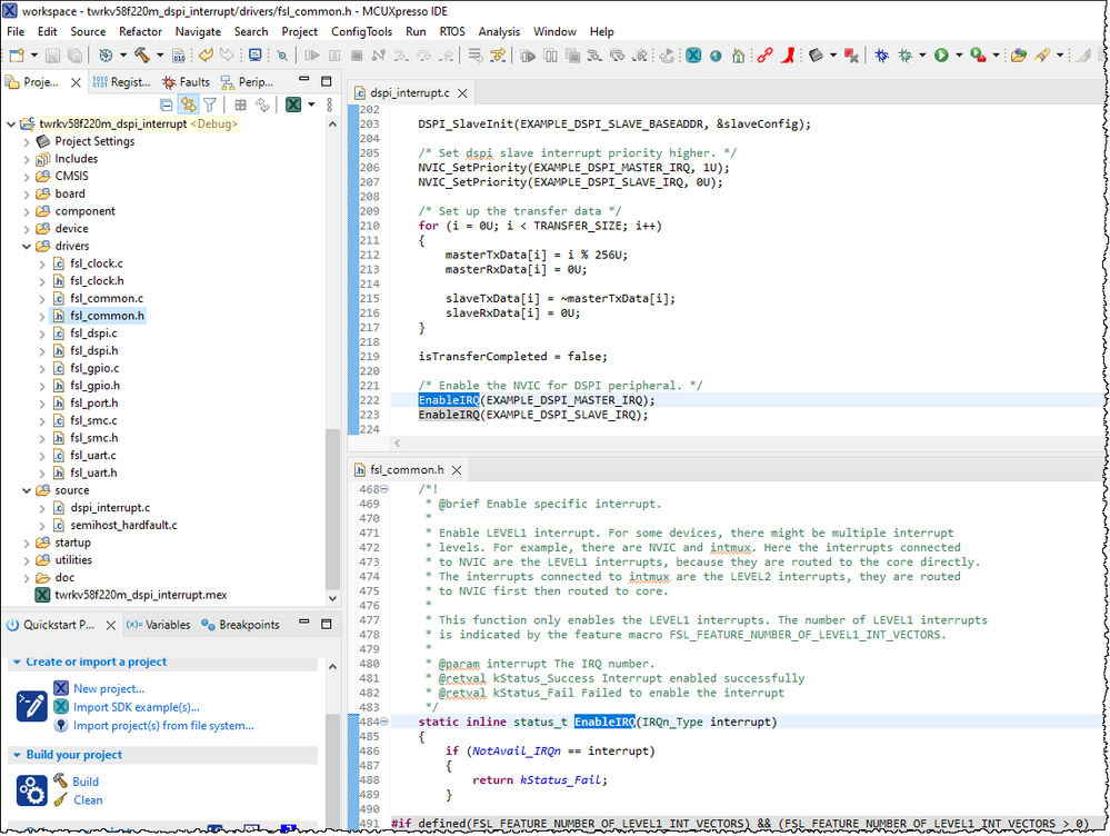

after update, four led blinks one by one, everything was all right. But when i add some other resource (for example SPI), application was stop in the DefaultISR. What's the reason? why application cannot enter into the right ISR?

There are several SPI examples in SDK_2_8_0_TWR-KV58F220M. Do you have reference to its peripheral initialization code and interrupt settings?
You can upload a simple test project so that I can quickly analyze the cause of the problem.

Thanks for your reply. I use "dspi_interrupt_b2b_transfer_master" from SPI examples in SDK_2_8_0_TWR-KV58F220M. And the test projects are attached.
