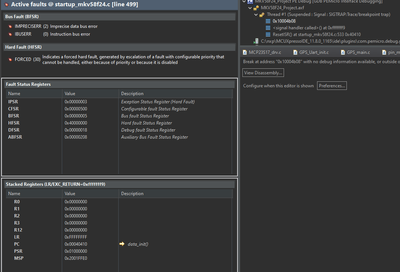

Good morning
I have a remarkable error on the TWR board. I used this board in the same condition previously and it worked, It was standing there for a while and now I start directly with a hard fault.
I am using the Multilink with the JTAG cable connected. I did previously. I start directly in a hard fault.
That's the screen shot
The jumper J19 and J20 are open for using the JTAG. It should be enough.
Please suggest something. I can only suppose it is broken..
Thank You everyone
Pietro

Hello @pietrodicastri ,
Thanks for your post.  To help determine whether this is a software issue, could you please check if the HardFault still occurs when running the demo included in the SDK, such as the “Hello World” demo?
SDK link: Select Board | MCUXpresso SDK Builder

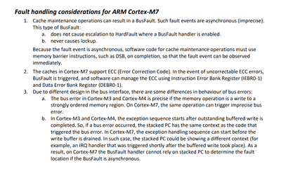

You may refer to https://www.keil.com/appnotes/files/apnt209.pdf  to know more details.

The board is now working ... I am grateful for the support.
