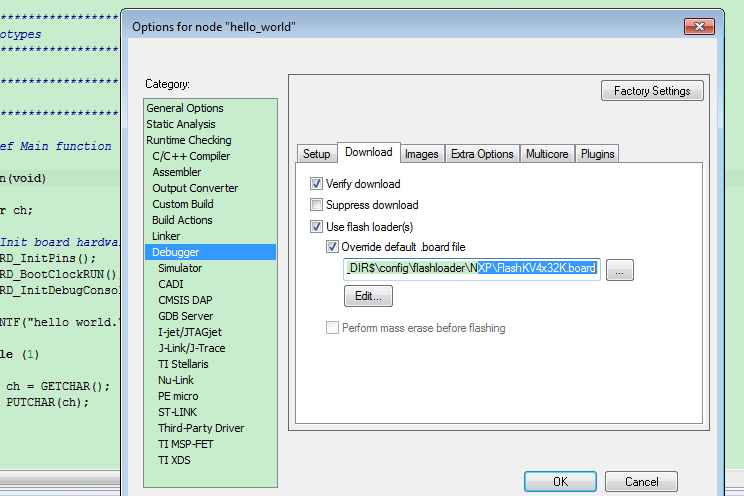

Recently, I was writing a uart_putString() function based on the uart_putchar() from the TWR-KV46F150M QSP. After I have downloaded the code to the board and try to test the uart_putString() function, I encountered an exception and then I quitted the debug mode. Ever since then, I cannot download any program to the board, including those which used to work fine from the QSP, like the LED Demo program. The error message was "The flashloader program reported an error. A fatal error has occurred, the debugger will now terminate". I experience the same error message whether or not I check the "Override default .board file" options under the "use flashloader" option.

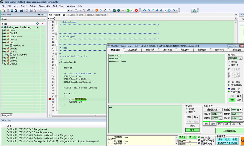

  Let's take the sdk helloworld project as an example:
\SDK_2.6.0_TWR-KV46F150M\boards\twrkv46f150m\demo_apps\hello_world\iar
  I have tested it on my side with the opensda debugger, it works OK.
My flashloader configuration is:
Even choose the .board, it the the same:

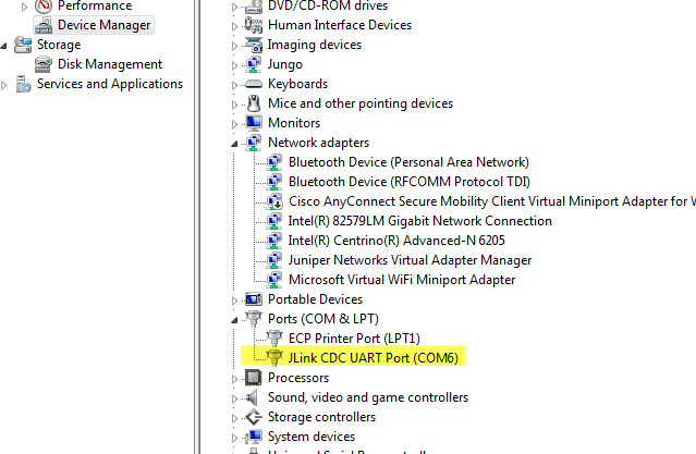

5) open the JLINK commander, check the connection
Can you find the ARM cortex-M4 core?
If you can't find the ARM core, you can input: unlock kinetis
Just do the mass erase.
If yes, then you can use the JLINK to debug the helloworld again.

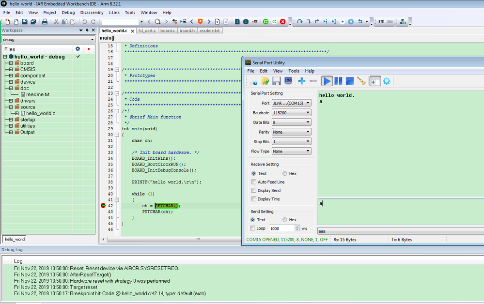

JLINK test result:
Please try it on your side again.

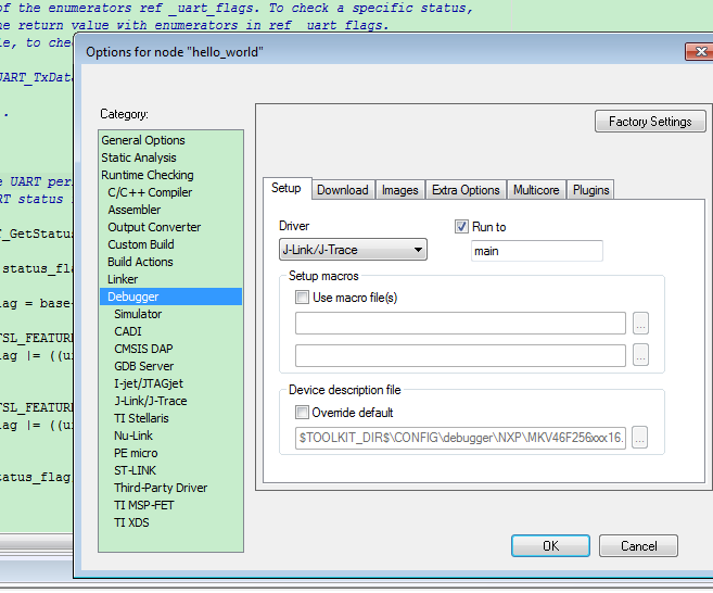

Thank you so much Kerrry! I followed your suggestion and switched to using the JLink debugger. Everything was going smooth, I could successfully identify the board in the JLink commander, then i changed my project to use JLink as the debugger. Now I can successfully use flash loader to download the program to the board.

I just followed your suggesting to download the latest SDK of my board but the same situation occurred. If I disable the flash loader, the hard fault occurs and if I use flash loader, I could not even start the debugging session because the flash loader reported an error.

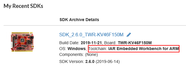

Below are the steps of how i downloaded the latest SDK.
1) I chose my board and selected the tool chain to be IAR Embedded Workbench.

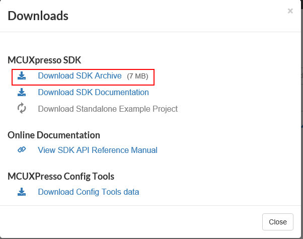

2) I downloaded the SDK archive file
3) I opened one of the IAR workspace. The one I used is listed below.

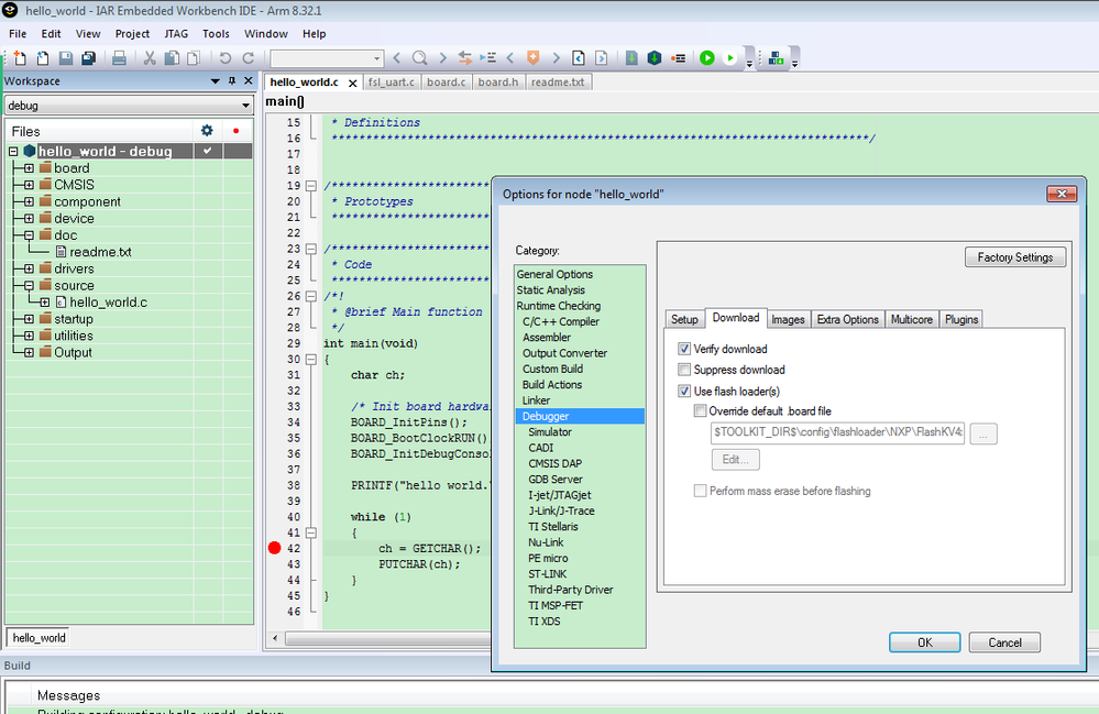

You side:  If I disable the flash loader, the hard fault occurs and if I use flash loader,
Please tell me which flashloader, please give me a screenshot about it, do you mean, your side, also have other TWR-KV46F150M board, but just one TWR-KV46F150M have this problems, right?

Sorry for not being clear enough in my question. The situation now is that if i select "use flash loader" in Project->Options->Debugger->Download in IAR, I cannot even enter debug mode when i download and debug (Ctrl + D), the error messages "The flash loader program reported an error, A fatal error has occurred, the debugger will terminate now" just pops out and ends my debug session. (Note that these error messages come out before i even get into debug mode).
However, If i do not select "use flash loader", I cannot successfully get into debug mode and check on registers and stuff. Its just that the hard fault occurs so that my program is stuck in one location, which can be observed from my screen captures in the post. The important part is that this hard fault occurs way before my main function starts, meaning that i cannot really debug things in my main() or observe any behaviour from the board due to my main().
