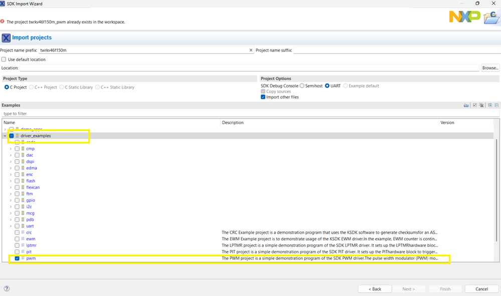

I am working with the TWR-KV46F150M evaluation board and using MCUXpresso IDE. I have downloaded and installed SDK version 2.8.0 for the TWR-KV46F150M. I am currently testing the PWM driver example by directly importing it from the SDK. i have attached the screen shot of the  example project i have imported from SDK.PWM_Driver_Example.pngPWM_Driver_Example.png
