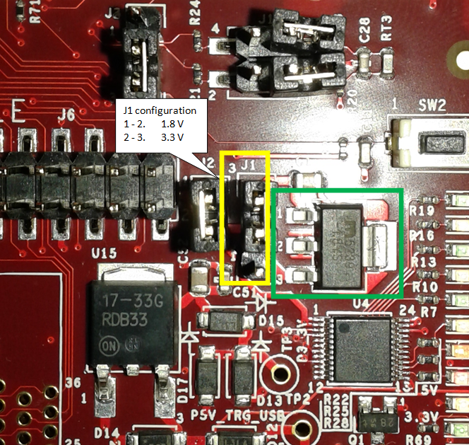

Hi guys,
When using TWR - KV10Z32 you must be careful while configuring the voltage selection jumper J1, the silkscreen can easily be misunderstood because of the numbers on the right that correspond to the voltage regulator U1.
If you are working with the 3-Phase Motor Control Tower System Module you must use 3.3V for correct operation.
