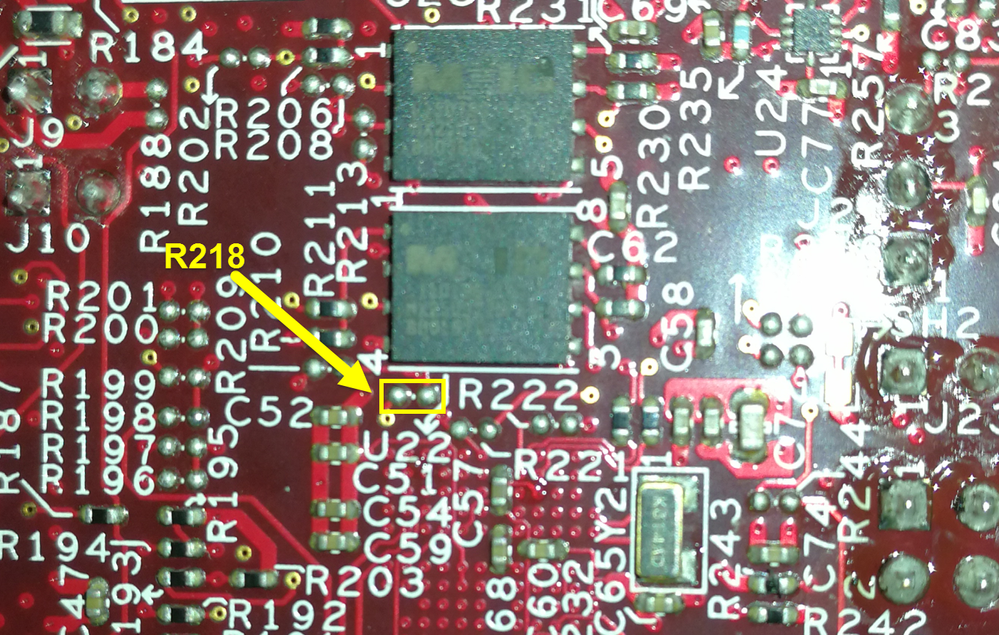

I have a TWR-K80F150 and I want to use the SD card slot. I follow the procedure into the TWR-K80F150M User's Guide :
"To use the microSD card, populate the R198, R200, R208, R58, R196, R218, and R244 resistors on the board with 0 ohm resistors."
I found all resistance except R218.
Do you know where is placed R218 on the TWR-K80F150?
Thank you in advance.
Patrice

Hui_Ma
After we checked the board Layout file, the R218 located at here.
Wish it helps.
best regards,
Mike
