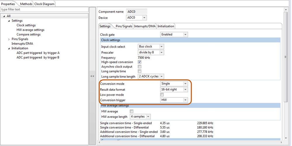

  • ADC:
    We configure every ADC module to use Single conversion mode, 16-bit format and HW Trigger.

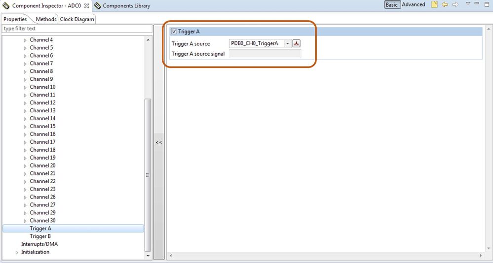

   Then, we configure pins used for Channel 0 and Channel 1. After this, we configure trigger sources for Trigger A and B (Select PDB0_CH0_TriggerA and PDB0_CH0_TriggerB respectively)

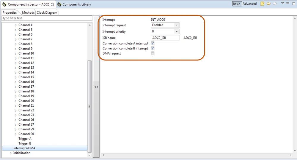

  We will manage results using interrupt mode, so ensure to enable interrupt for every ADC module in both conversion complete (A and B):

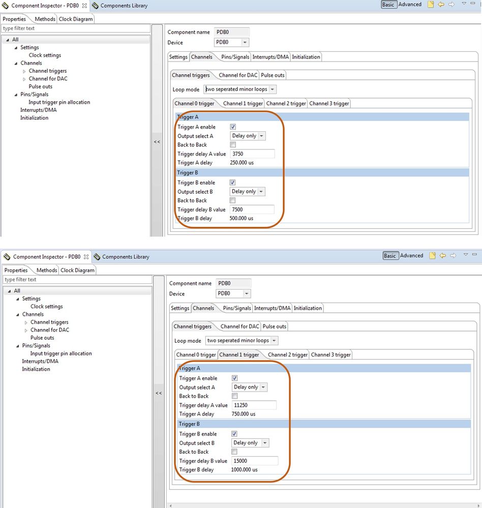

In next tab (Channels) we configure Channel 0 trigger and Channel 1 trigger to generate triggers at 250 us, 500us, 750us and 1ms:

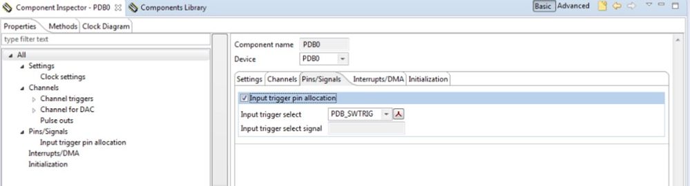

PDB Channels.jpgThen, in Pins/Signals tab, we can select up to 16 different input trigger sources (the trigger to start counting), in this case, we select software trigger.
Software Trigger for PDB.jpgNow, that's it.
We have configured both peripherals in order to be read one ADC channel every 250 us (so every 1 ms we will read these 4 channles).
