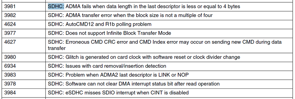

Check the K70 mask that you have and the errata that belongs to it. There are various issues with ADMA and the SDHC as shown below (eg. from 3N96B)
You may find that you need to follow workarounds to solve some difficulties.

I have checked this errata list before and didn't find which errata id is matched with my issue. I try to transfer the data with signle block by SDMA, all the data can be written into sd card by this way, but when I try to read it from sd crad, the similiar issue like writing data occurs, the data is not the expected data and mix some other block data. I have tried to read data with single block mode and multi block mode, the issue always occurs. Do you have any ideas for this?
Thanks in advance.
