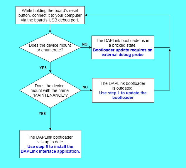

I'm working with a TWR-K65F180M.  It was working fine, and then it stopped, and the D3 LED is blinking orange but nothing else is on.  What does this mean?
1,965 Views
Robin_Shen
I am not sure if you are using host PC with Win10.(It has been reported that OpenSDA v2/2.1 bootloader could be corrupted when the board is plugged into a Windows 10 machine.)
Please refer DAPLink bootloader update to check the state of your board is corrupted or bricked.

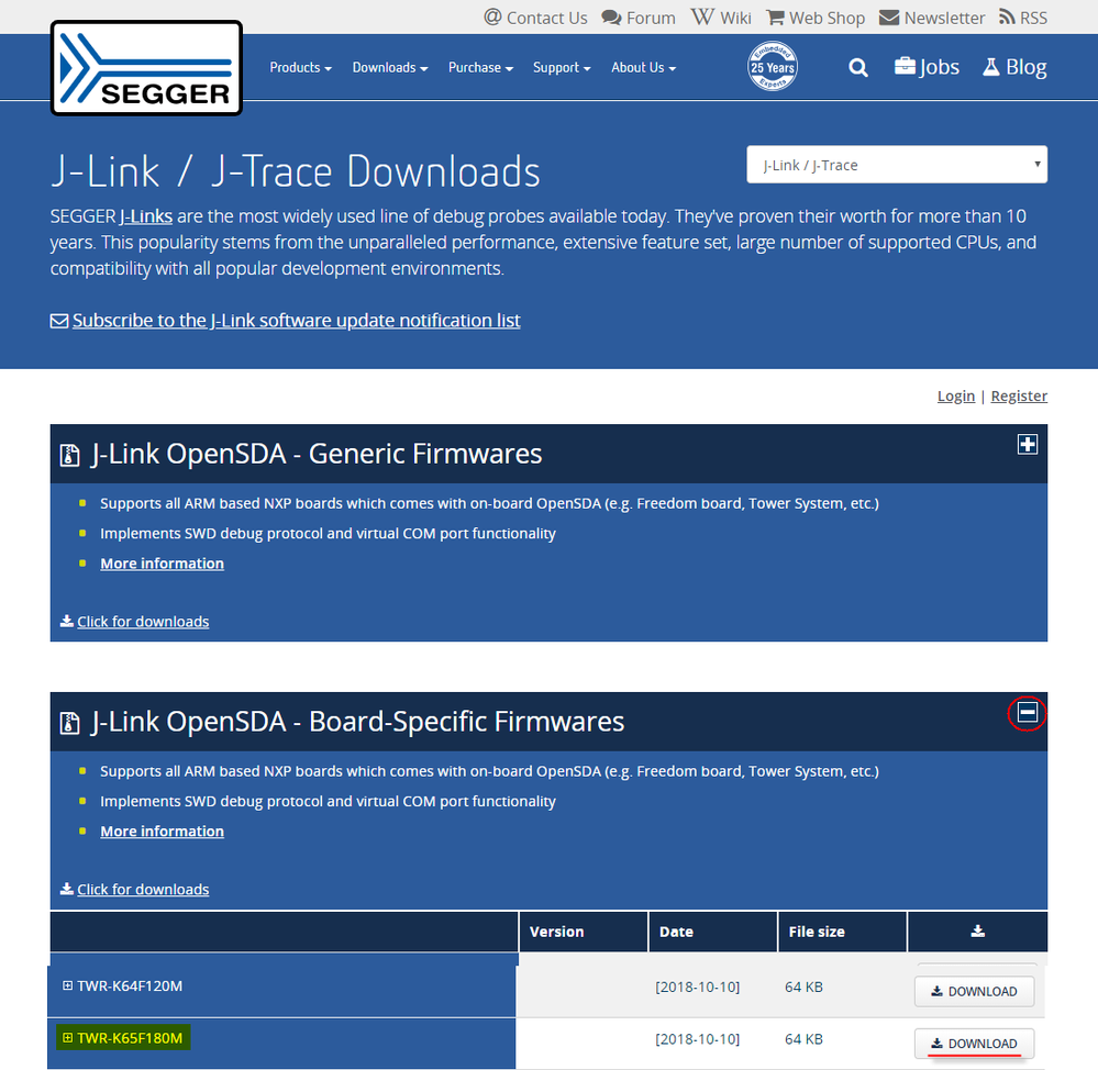

I have attached the bootloader(0244_k20dx_bl_0x5000.bin).
The J-Link OpenSDA - Board-Specific Firmwares(27_OpenSDA_TWR-K65F180M.bin) need to download.

ashley_gross
I had thought the device was bricked, but it turns out that it wasn't recognizing the device when it was plugged in to a USB hub.  When I plugged it in directly to my computer, I was able to mount it.
I followed the instructions and downloaded the bin you attached above to the device.  As soon as it finishes copying the file, it unmounts, and the orange light starts blinking rapidly.  When I dis/reconnect it, it's back to the same state as before, nothing.
1,965 Views
Robin_Shen
If use step 1 to update DAPLink bootloader failed by using 0244_k20dx_bootloader_update_0x5000.bin.
Have you try to: DAPLink bootloader updates with external debug probe? (I am not sure if you have external debug probe.)
