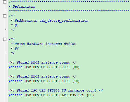

I had done a test with KSDK V2.2 for TWR-K65F180M board.
I modified the <usb_device_config.h> file to enable EHCI.

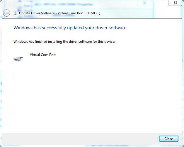

The USB CDC VCOM worked as expected:

I havent enabled EHCI like you mentioned! Now it is working!
