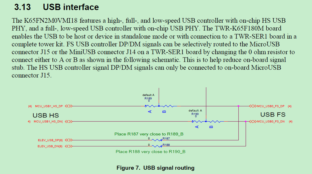

I have a TWR-K65 board where I can run the usb-device-cdc-vcom-example using the USB-HS port. Using the TWR-K65 standalone this works!
But as soon as I connect the TWR-SER to the tower stack, it stops working.
It seems that the K65 sees the USB bus permanently in reset state.
My goal is to use both USB (USBHS and USBFS). The USBHS over the USB connector on the TWR-K65 as a device and the USBFS over the USB connector on the TWR-SER as a host.
Any ideas whats wrong?
Thank!

The TWR-K65F180M board user guide shows below info:
So, we need to use USB HS with on-board Micro USB connector J15 and USB FS with TWR-SER board J14.

Please check you are using TWR-SER board as USB FS connector. And the TWR-K65F180M R189 and R190 using 0ohm resistor at side A, not side B.
If K65 FS USB as USB host, the TWR-SER board jumper setting J10 1-2, J16 1-2.

thanks for your detailed answer!
It was not working with your setup.
But I figured out I have to remove on of the both jumper at J23 on my TWR-K65. Now it is working as expected.
