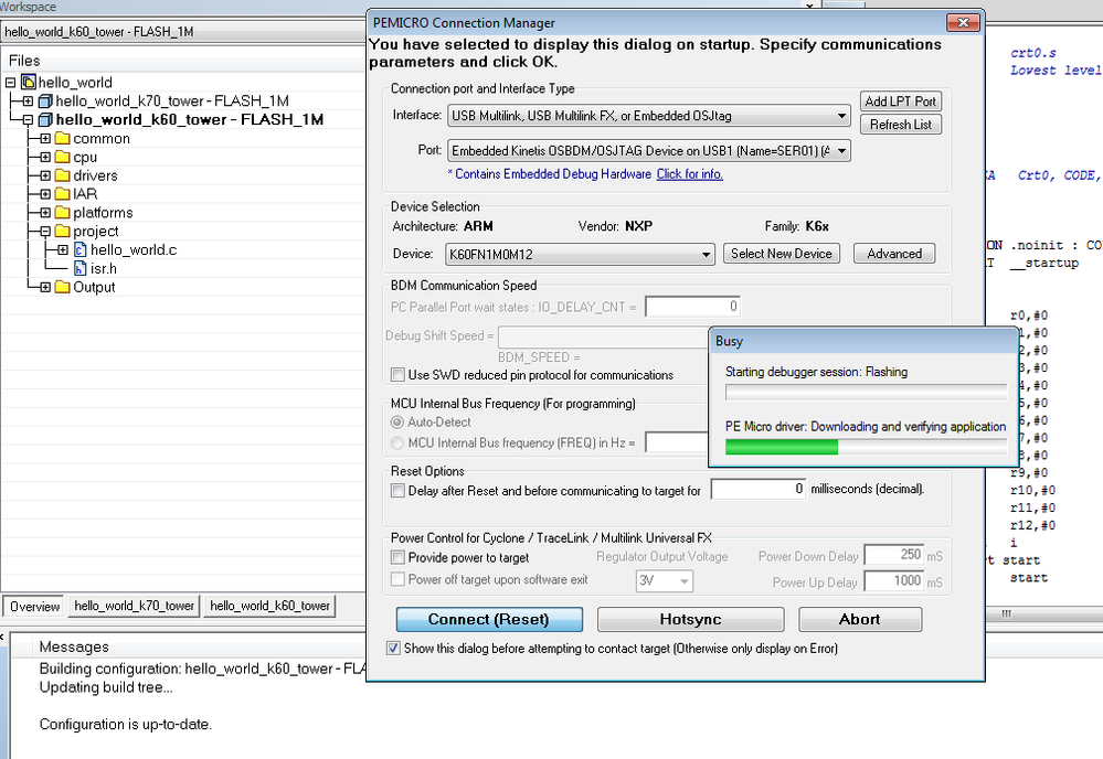

I tried the following setting, it works, could you please try it ?
4,579 Views

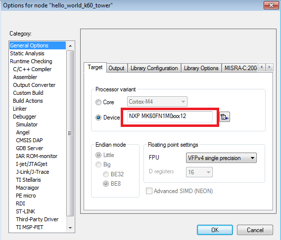

All of my testing has been done with Freescale MK60FN1M0xxx12 as the device. This works in RAM mode and I'm getting output on UART5.  The device was the same between the RAM and Flash configurations.

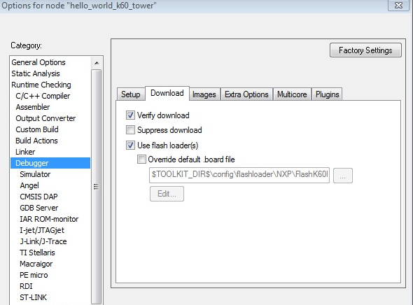

Also, as I mentioned,
I opted to modify Options->Debugger->Download so kept Use flash loader(s) checked but no longer checked Override default .board file. Same errors.
However, I re-ran it this morning and got the same errors: "The flash loader program reported an error" popup then "A fatal error has occurred. The debugger will terminate." popup with nothing of note in the Debug Log:

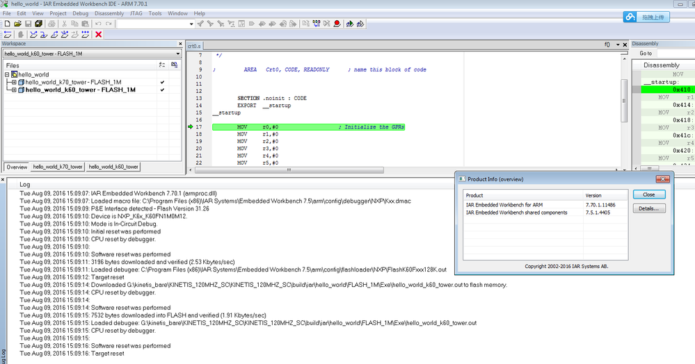

Hi Elecia:
I tried this demo with both IAR 7.60  and IAR 7.70,  the results are pass, please see the below picture.
