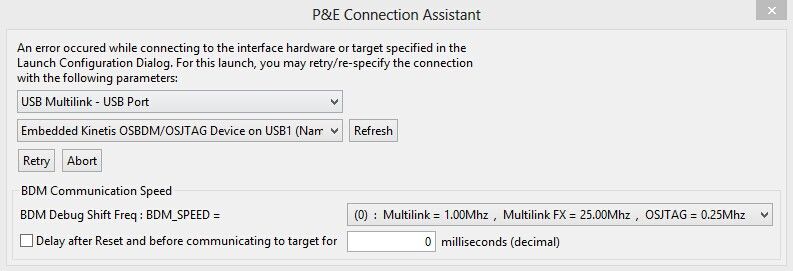

I am a starter with Freescale products. I currently have a Tower system TWR-K60100M with a MK60DN512VMD10 MCU.
I am using Win 7 and Codewarrior 10.6.
When I tried to download the program onto the board, the error window pop out:
If I click Abort, the error message is:
Error launching HelloworldBareBoard_FLASH_PnE U-MultiLink. ARM GDI Protocol Adapter : Can't connect. The Debugger can not connect to the P&E device
Some other info for your consideration:
I have already updated the bootloader firmware so the hardware connection is OK.
I have tried both CodeWarrior 10.6 and 10.2. Neither works.
I have tried all BDM Debug Shift Freq. Doesn't help.

I suspect that some signals of the TWR-SER module interfer with the debug signals.
There is nothing in the IDE you can let it know about the TWR-SER present (and that would  not make sense).
Maybe a powering issue? Are you powering the system in addition (recommended) through the TWR-ELV USB connector too?

yicui
The system is programmable with TWR-SER module removed.
The whole system (MCU+2 elevators+TWR-SER) is programmable when the  serial module is at the second or the third floor from the bottom. I guess the system was just not recognizing the serial board in these cases.

yicui
Exactly.
Once a second mini-USB is connected to the TWR-ELE board, the system is programmable.
Thanks for your help.

BlackNight
I don't have the problem. It works for me if I power the tower boards (elevator, cpu module and TWR-SER) only with the CPU card USB connector.
I suspect that your PC might not deliver the needed amount of current (mA) necessary. I have seen cases where e.g. with using SD card, a lot of cards/peripherals the power provided to the tower system was not enough, and caused debugging failure.
