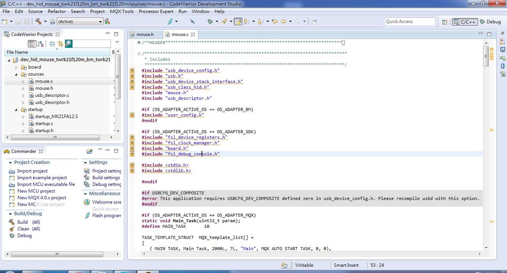

張峻瑞
I download and install KSDK1.1.0_K21FA_1.0.0, then import C:\Freescale\KSDK1.1.0_K21FA_1.0.0\usb\example\device\hid.
But has lot file not find, how can I do?
Thanks very much.

adriancano
The KSDK is not supported by CodeWarrior, the IDEs that support KSDK are:
  • KEIL MDK/uVision.
  • Kinetis Design Studio IDE.
  • Atollic TrueSTUDIO.
  • ARM GCC
You can find the complete information about the KDS IDE HERE.
Hope this information can help you
