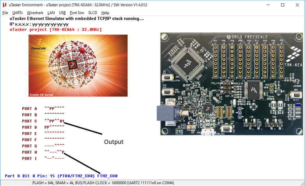

Your problem may be with
 /* Select Pins corresponds to the PTC0 for output */
     SIM_PINSEL |= SIM_PINSEL_FTM2PS0_MASK;
This selects the FTM2_Ch0 output to be on pin PTH0.
See the simulation of your setup in the uTasker TRK-KEA64/KEA64 simulator below:

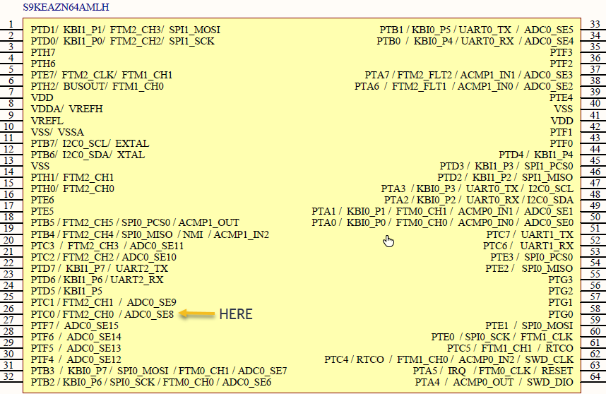

I am really confused. According to KEA64 Sub-Family Reference Manual PTC0 is on FTM2_Ch0.
It looks like this:

The default location of FTM2_CH0 is PTC0 but if you set
you are switching it to its alternative location of PTH0.
Mark

If you leave the SIM_PINSEL register in the state that it has out of reset it selects PTC0.
It is good practice to still set it to its required state.
