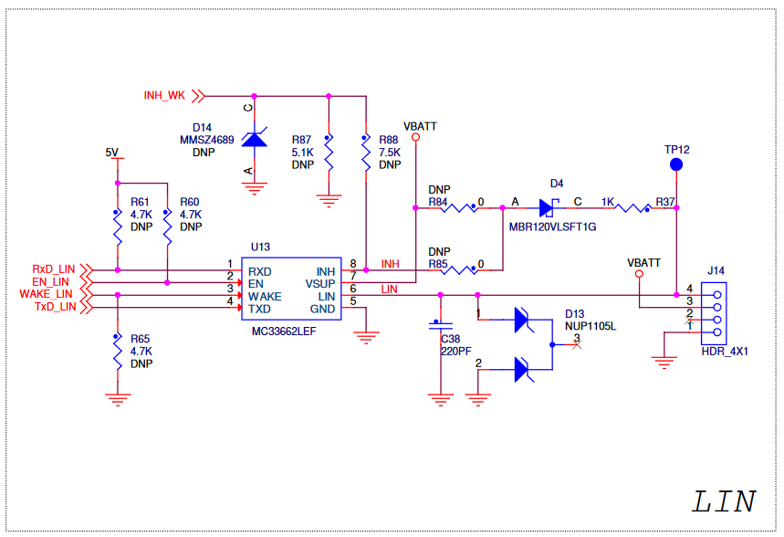

What's the recommended hardware configuration for getting the TRK-KEA128 to function as a LIN Master?  I'm thinking R61 needs to be populated.  I'm using example LIN Master code found in KEA128_LIN_Master folder C:\nxp\FSL_LIN_2.x_STACK_Package_4.5.9\Examples\Kinetis\KEA128.  I'm not getting LIN Master communications with the board as shipped.

    You can add the R61, or enable the internal pullup in PTB0 by configuring:
  PORT_PUE0 |= 1<<8; // pullup is enabled for port B bit0.
   Actually, we have test the LIN function between two TRK-KEA128, one is as master, another is as slave.

We got the KEA board working with populated R84, R85, R61 and I enabled EN_LIN and WAKE_LIN from software.
I am trying to port the code to K66 controller. Is there any configuration I have to do in extra than for KEA128?
